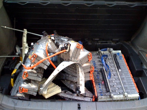

  12. ken1784
    ken1784 SuperMID designer
    Dec 18, 2003
    2,943
    1,380
    67
    Yokohama, JAPAN
    If you are good at electricity, you will not see following picture's result. :)
