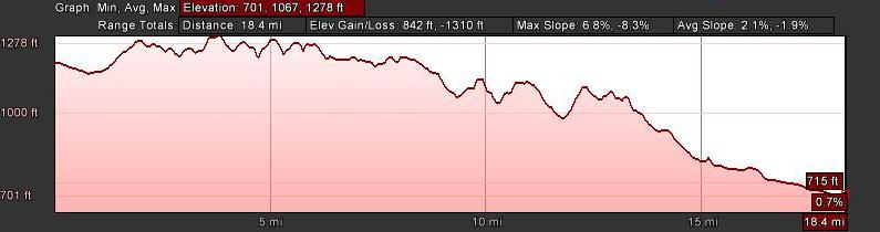

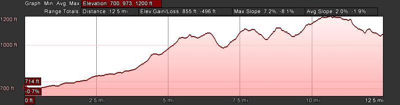

    I am posting below the elevations for the 2 trips when the car started out warmed up. These elevations explain a lot. I hadn't realized this before. I suspect that the elevation difference might be the prime factor more so than the charging of the battery.
    Trip 2 elevation profile--read from left to right--85.2 mpg:
    Trip 3 elevation profile--read from left to right--mid 50s mpg:

  15. css28
    css28 Senior Member
    Feb 27, 2012
    1,566
    443
    Suburban Detroit
    I commute 20 miles each way. My employer is 300 ft lower than home. I generally get about 10% - 15% better mileage going to work than coming home.
