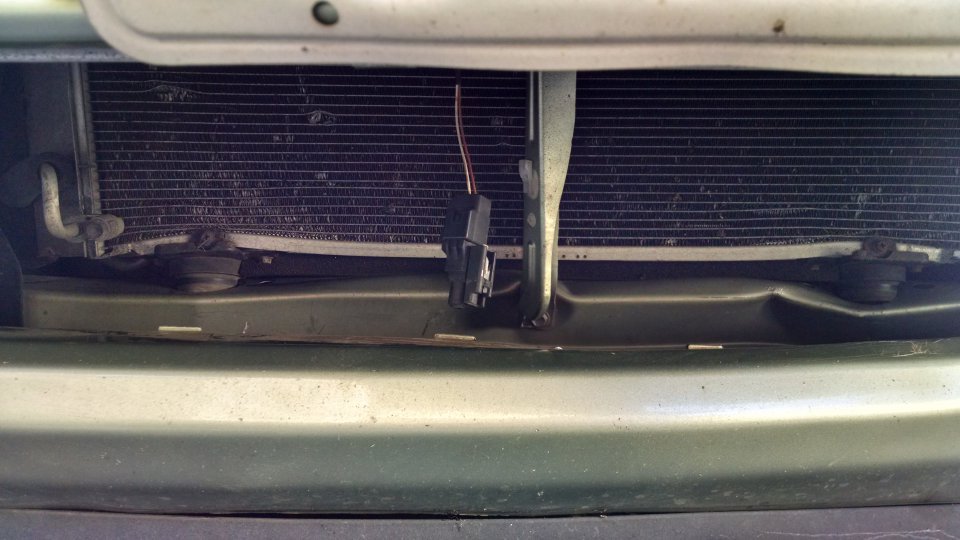

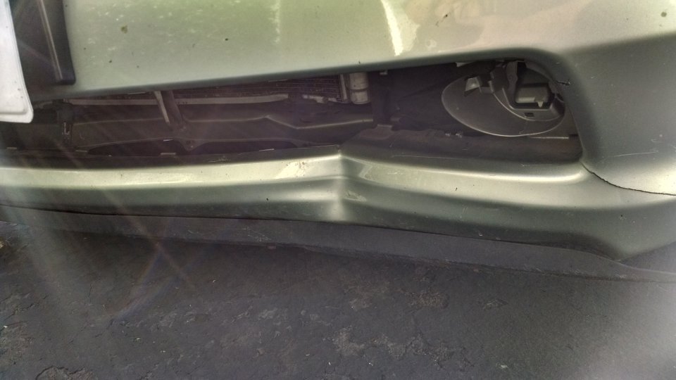

    I was driving home from work, it's a 3 lane highway (395, Central/Northern California), I was on the middle lane, cars in front and back of me, it was rush hour, a brown fox runs from the right hand side right in front of me, I stopped on the brakes, slows from 60 MPH to around 45 MPH, but I couldn't avoid hit him and ran over him. I looked at the rear view mirror, and he somehow got up, and gallops back to where he had run out from. That's the last I saw the brown fox.

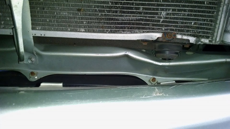

    I got home, about another 15 minute drive, mostly on the highway. Took some pictures of the front damage the fox caused. I hope he's okay. Don't want to kill any living thing. It was unavoidable, there were cars speeding next to me and behind me, as well as in front of me.

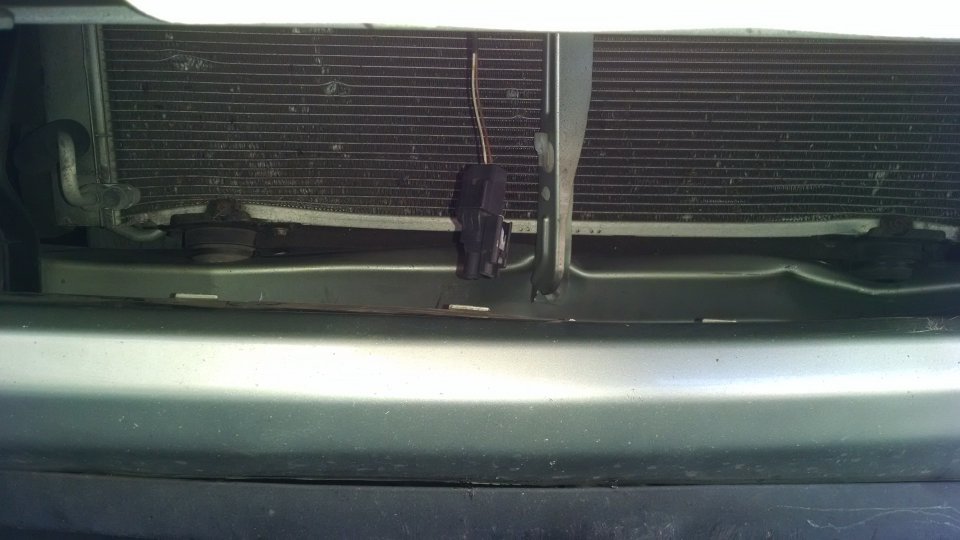

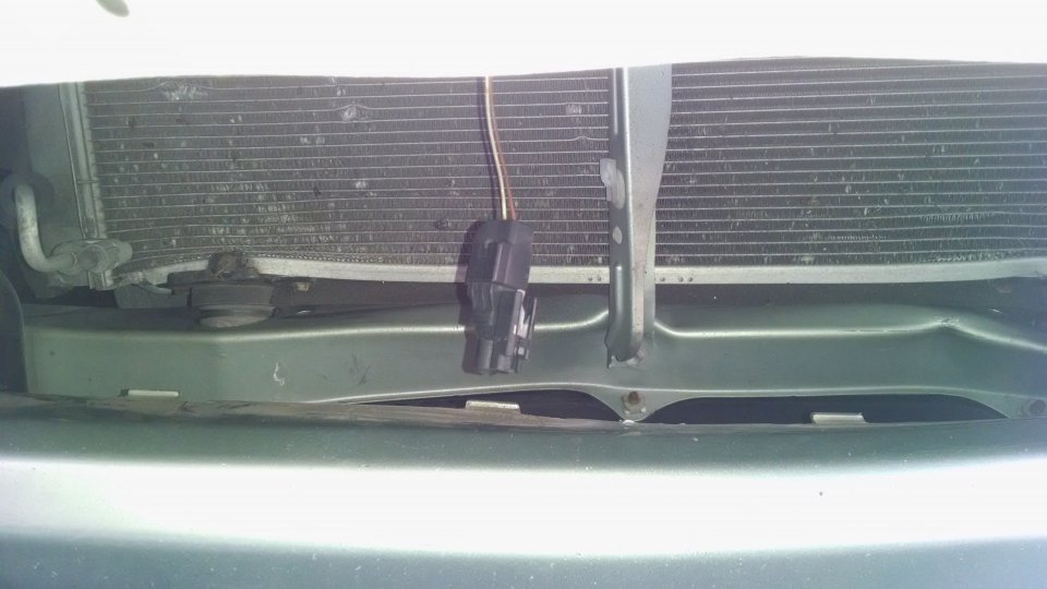

    What is that electrical connector hanging in front of the radiator/condenser?
    Prius drives fine, no error codes (I have Torque app), coolant temp stays around 180 F, no strange noises, aside from cosmetic damage, what else do you see?
    I am thinking about reporting it to my insurance (AAA) company, but I have a high deductible ($1000). Should I or not? What are some of the insurance implications in this case?
    Anything else you can suggest or advise?

    You're probably looking at about $2500 in damage to fix the car as before....or you might be able to negotiate a lesser price for a "good enough" repair to the radiator support, grille, etc.

    What is that electrical connector hanging down? Where's it connect to?
    How do you remove the front bumper?
    I think I can take the radiator off, but any suggestions are welcome.

    did it come off the fan? can you see what it might plug into? thetas a lot of damage from little brown foxy! i hit a coon the size of a buffalo a few months ago and just barely cracked the lower lip.

    yes, there are two behind the radiator.

    I opened the hood and took a look. The electrical connector was originally clip attached to the vertical bar holding the hood latch mechanism, looks like a temperature sensor for the condenser. I moved it out of the way, so it won't bang around anymore.
    Now, when I tried to close down the hood, it won't stay locked, I mean it will catch the lock but it won't go lower to the completely locked position. I regret opening the engine hood for a look-see. I think the impact pushed the condenser and the vertical bar a bit inside.

    That hanging piece is the MFD external temperature sensor, and clips to the vertical support. If it's broken it's only $20.

    your core support is bent and it wouldn't surprise me if the a/c condenser is damaged enough to leak. call the insurance company or at least take it somewhere and get an estimate for all the damage right away. insurance company shouldn't jack you up too bad; no ticket, no other cars involved. btw, you sure it wasn't a coyote? awful bad damage for a fox. and if it was a coyote, good riddance.

    MFD is still reporting the correct temperature, so the sensor is fine except its plastic clip to the bar is broken.
    It could've been a coyote, do they come in brown color?
    How safe is it to drive around with the hood partially unlocked? The closest mechanic I trust is about 45 miles away.

    This can be fixed with a tie-wrap. The attached thermistor is pretty resilliant. You just don't want it flopping around. You're going to want to make sure that your radiator cooling fans are still operative. Technically I think that you're in SoCal which means it's going to get warm soon.
