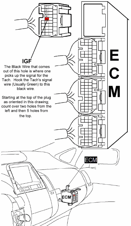

    This should help:
    That's from Tom Stangl's VFAQ.com site. I think he used to have images of the installed tach on the site and other instructions, but I can't find them. He installed his in the glove box, I think.
    Should be very easy to do.

    <div class='quotetop'>QUOTE(efusco\";p=\"75375)</div>
    So, the TACHO signal is pin5 of D connector same as Japanese models.
    Yes, it is.
    The other signals we got are...
    Pin3 of A connecter: INJ
    Pin 19 of A connecter: THW(coolant temp)
    Pin 20 of A connecter: THA(intake-air temp)
    Pin 9 of D connecter: +12V
    Pin 7 of A connecter: GND
