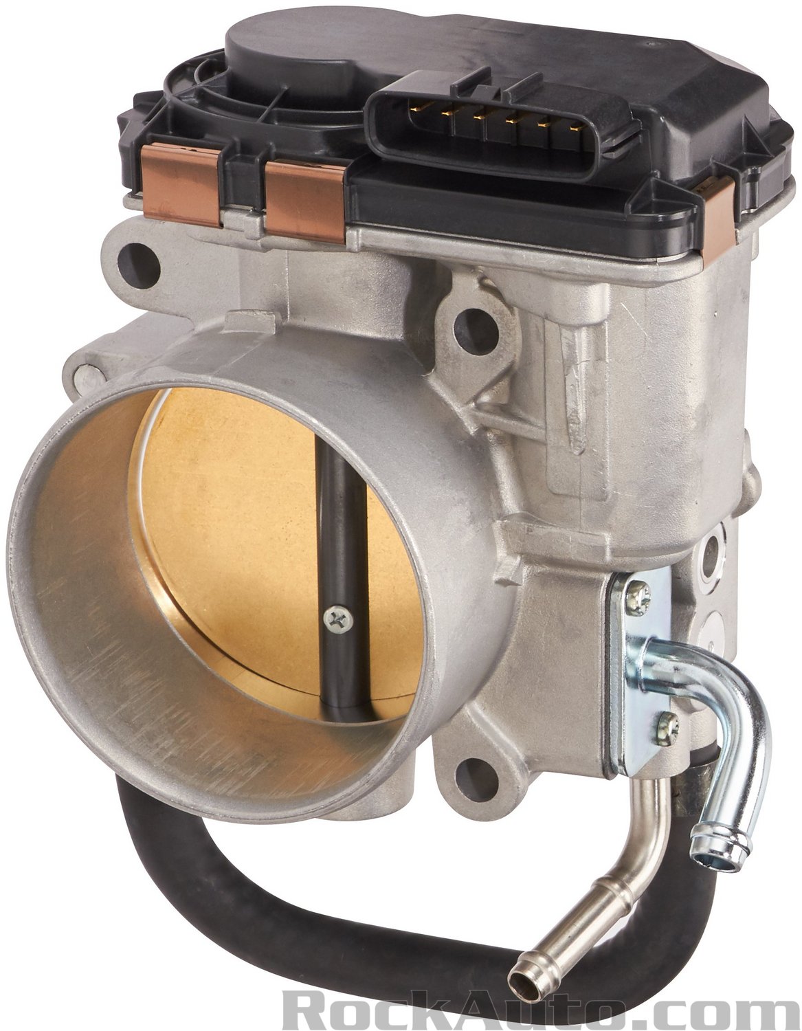

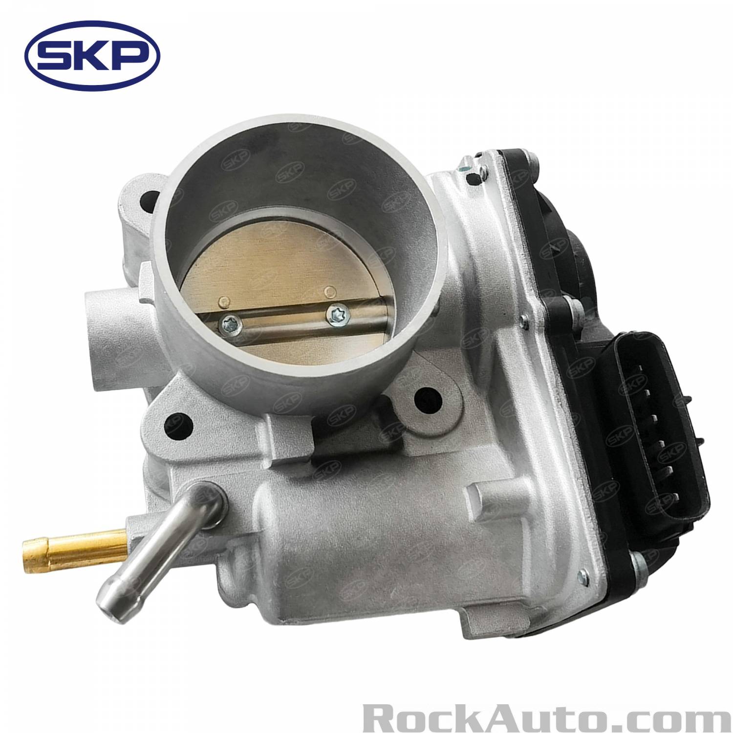

    But here is where it gets interesting. Around 2003, Toyota went to a fully non adjustable design on some of their models. The throttle position sensor and motor incorporated into the same shell and used the same connector.
    Here is a throttle body of a 2003 Land Cruiser:
    Here is one off a 2004 Corolla:
    No adjustments AT ALL. Not at the throttle plate, not at the TPS.
    Now by Gen3 (2010) Toyota switched to the 1.8 engine, and it was finally given the non-adjustable throttle body.
    Sorry for the rant, it just makes little sense. Toyota obviously had the tech to make a upgraded design for the Gen2 throttle body, as evident from the 03 Land Cruiser.
    The Gen2 Prius throttle body seems more like a prototype. Like they put all those adjustment points to refine it, but never made a new design out of it.
