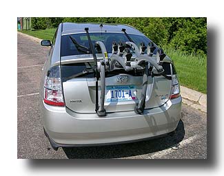

    Hello everyone I`m new here. I have a 2009 prius and a bike rack from my 2003 highlander. The bike rack is the universal type that touches the car in two places with padded rubber. Then it has straps to attach it to the car. It should fit any car based on the instructions. My concern is the prius and its glass under the wing in the back. Is it OK to put all this pressure on that wing section? I attached an image of the type of rack. Has anyone used this type of rack on the prius.

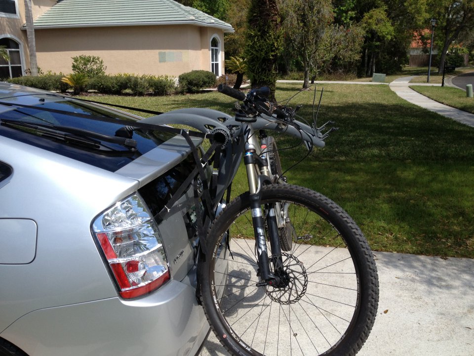

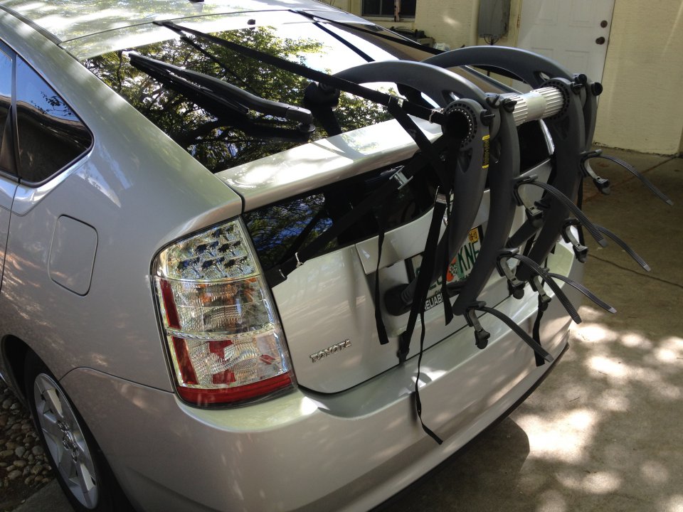

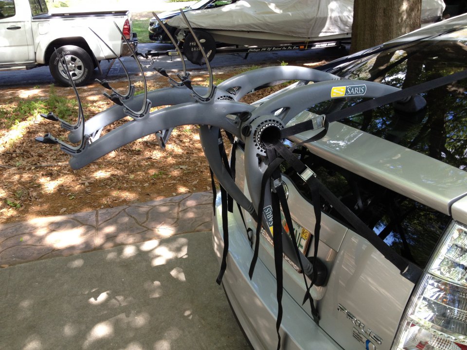

  5. TampaPrius.com
    TampaPrius.com Active Member
    Feb 20, 2013
    461
    300
    Tampa, Florida
    I use a Saris bones III that is similar with no problems. IMG_4035.JPG IMG_4035.JPG IMG_4037.JPG IMG_4038.JPG

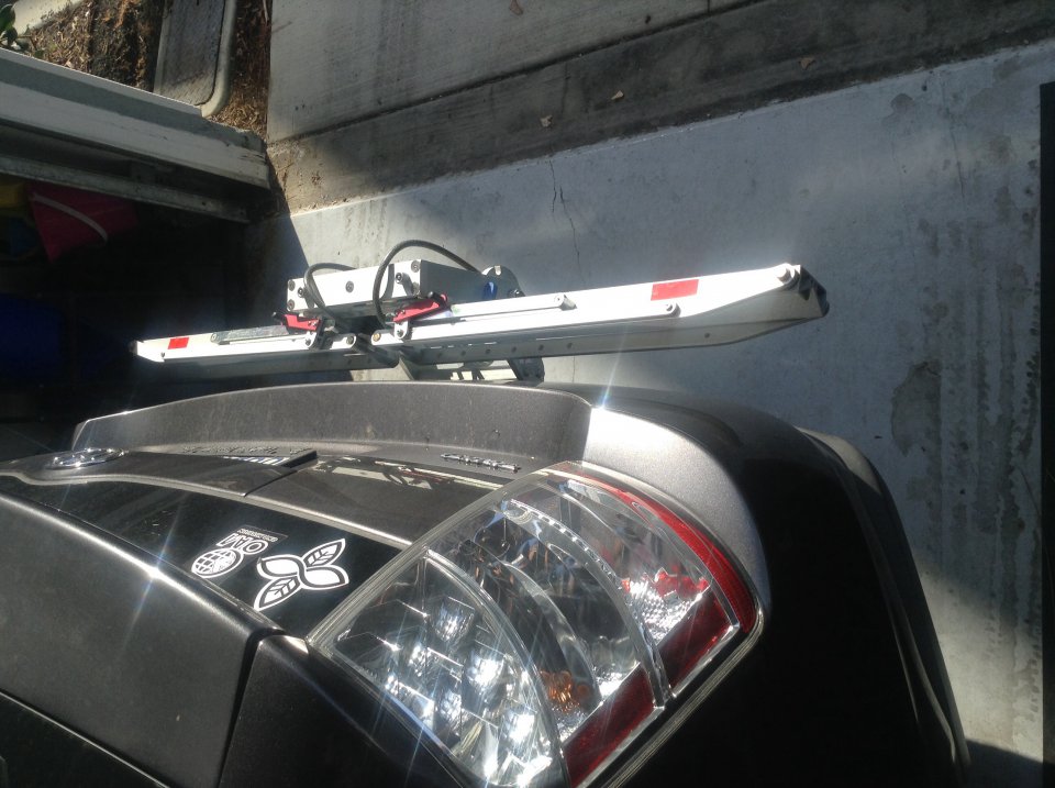

  7. ewxlt66
    ewxlt66 Active Member
    May 1, 2008
    535
    186
    Dana Point, CA
    Hitch much better IMO. More stable. Access to hitch. No paint contact w either car or bike. Ours from 1UPUSA.com :: Home is so clean and tidy. We love it. image.jpg
  8. john1701a
    john1701a Prius Guru
    Jan 6, 2004
    12,793
    5,275
    57
    I used this Saris for many years, on both my 2004 Prius and the 2010...
    ...except I located the feet on the bumper, directing about 95% of the weight there. That way, the glass contact is virtually nil and only serves the purpose of stability.
    Recently, I upgraded to a receiver-hitch... at triple the cost. The strap-on rack is definitely the better priced option. But being able to lock a rack and carry 4 bikes with little effort was a big draw. You can still open the hatch too. I leave the rack on the entire vacation, not having to find a place to store it when not in use during trips is nice. It folds down as well, allowing me to load our 3-wheel recumbant inside without having to remove the rack.
    Do some searching in the forum. You'll find a number of threads addressing bike carrying options.
