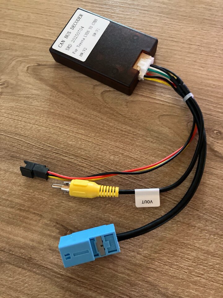

    I just installed this LVDS to CVBS adapter.
    Patched the 3 cables to the wire harness of the Pioneer.
    I concluded that the black cable is for ground, red for 12v and yellow for B+, permanent 12v.
    Unfortunately on the Pioneer, when I open the camera menu, it shows "no video input"
    Any idea how can I try to fix this ?

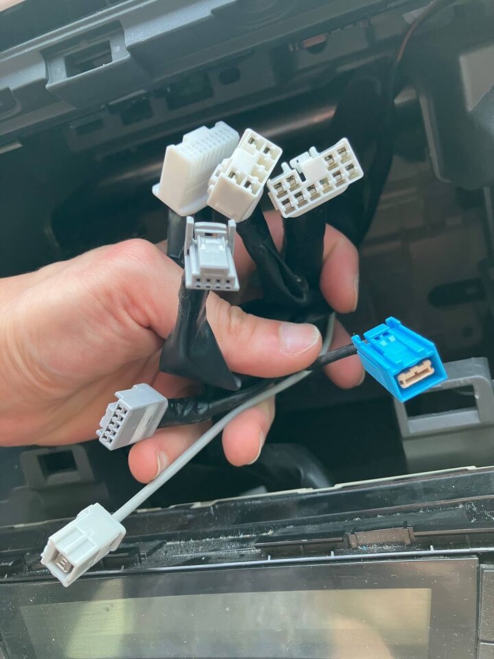

    Here are the cables going to the original Toyota multimedia device.
    Best regards
