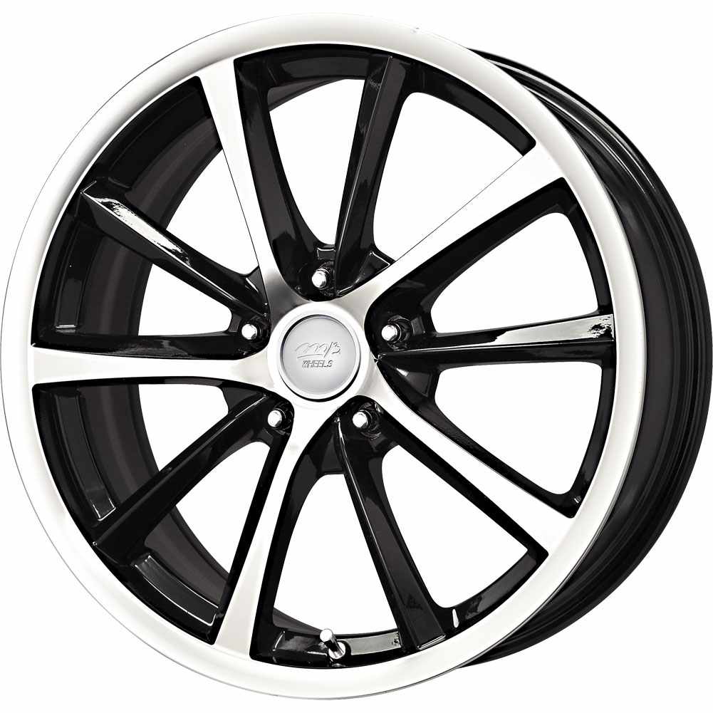

    I emailed Discount Tire today and was told the 15x7 wheels weight 16.3lbs. The 17x7.5 weigh 20.2lbs. The 17s look a lot nicer but...
    Here is what the other version of the wheel looks like.

    Those are very nice too. They would look good on a Winter Gray Metallic Prius. :)

    Aye, the theme is similar to a lot of OE wheels coming out on cars like the FR-S and a new Porsche or was it Aston Martin?
