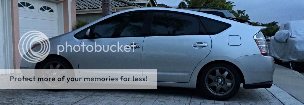

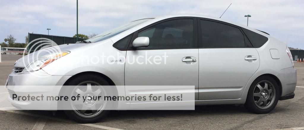

    BEFORE:
    AFTER:
    I'm sticking with these STOCK 16" TOURING wheels and have NO plans on changing them. So, if you have the same setup, what would you recommend for wheel spacers? I Don't want to be considered HELLA FLUSH and def. don't want to ROLL the fenders. Let me know your thoughts on a SPACER? 5mm, 10mm, etc. If you are happy with them please post up a link of where you purchased from.
    Thanks for looking!!

    On my 2008 Silver Prius, after lowering my car, I really wanted a more even flush look and not tucked. I ended up with 15mm front and 25mm rear. Really made the car look more balanced. Originally had 8mm on the front and it wasn't enough so went with the 15mm. Also went from a 30mm in the rear to a 25mm because I started to rub.
    On my 2007 Grey Prius, with the 19x7.5 Wheels & 215/35ZR19 tires, I didn't need the spacers and I still don't rub. :)

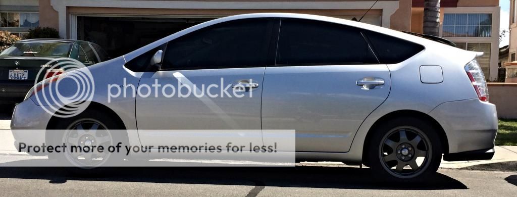

    UPDATE: So i have about 500+ miles on the car so far and really enjoy the difference it made, It's fun to drive in the turns, although... not a race car but it's fun to carry more speed into the turns with minimal body roll. It's my wife's car so I had to teach her how to enter driveways without scrapin' the air dam. It's not slammed or near it but gives it a good stance. I do feel that i ride the rails in the Costco car wash. Lol .I believe that these springs B&G Springs are Linear rate compared to a progressive rated spring so feel the road (bumps) I'd rather have a controlled ride rather than a spongy boat feel.
    I have the G7 Stiffener and noticed a difference compared to the stocker. I also noticed that the car feels like it has a slight understeer. Would the Cusco front brace help? Don't know if i would go as far as putting a front sway bar but since i'm this far i might as well. Please give me your thoughts.
    BEFORE/AFTER/After 500+ Miles with the springs settled in.
    25.75" Driverside front / 24.50" / 24.25"
    26" Passenger front / 24.75" / 24.25
    25.25" rears / 24.75" / 24.50"
    Overall, i'm satisfied and would recommend these springs to anyone.
    New Pic: [​IMG]
