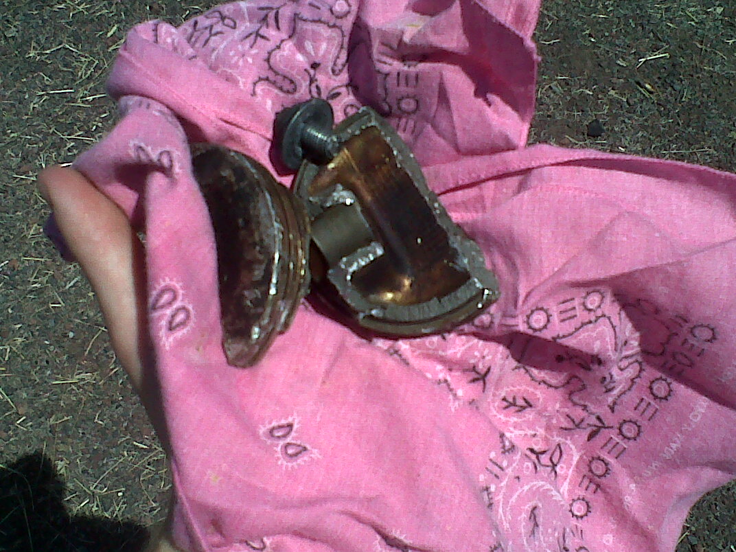

    So my 2002 Prius went kaput today. As far as I can tell, I threw a rod and blew a piston. The severed rod and piston head came pummeling out of the engine and hit the ground, then the undercarriage, then spun out the back of the car into the highway. I retrieved these parts (see photo) from the road.

    Sorry, here's a URL of the photo of the piston head that blew out. The rod, and piston itself also came out. (I just didn't take a photo of them...)
    (aych tee tee pee)://fullersfield(dot)files(dot)wordpress(dot)com/2011/08/prius-piston-head(dot)jpg

    Here's the photo for you:
    I was wondering how on earth you blew a Toyota engine so early. When the car says low oil, it means it. $5 worth of oil just cost you a complete engine
    you can find engines on eBay, at junkyards, that sort of thing. It is usually cosmetic damage that "totals" a car.
    It looks like $250 to $450 is the going rate right now: Crate Engine | eBay
    $340: 01 02 03 PRIUS ENGINE 1.5L | eBay
    I would not consider this a DIY project unless you are competent with vehicles to begin with. I am not as intimately familiar with the GenI as the GenII and GenIII so I am not sure if the engine/MG1/MG2 are all one "unit" or are different and put together, or how that works. But for the price it might work.
    FYI, when my Subaru needed a head gasket at 315K miles, it was $500 for a used engine and $1400 to install it with a mechanic I trust. I sold it to the scrapyard for $125 and that was that.

    That's impressive, but the photos I wanna see are of the remains of the engine! :eek:

    It's not my photo, it is just web-ized from the text posted. Under X posts you can't post links/urls/photos so I just made it viewable for others. :)
