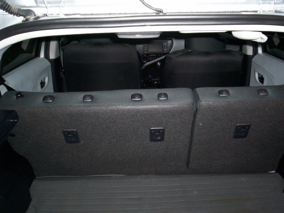

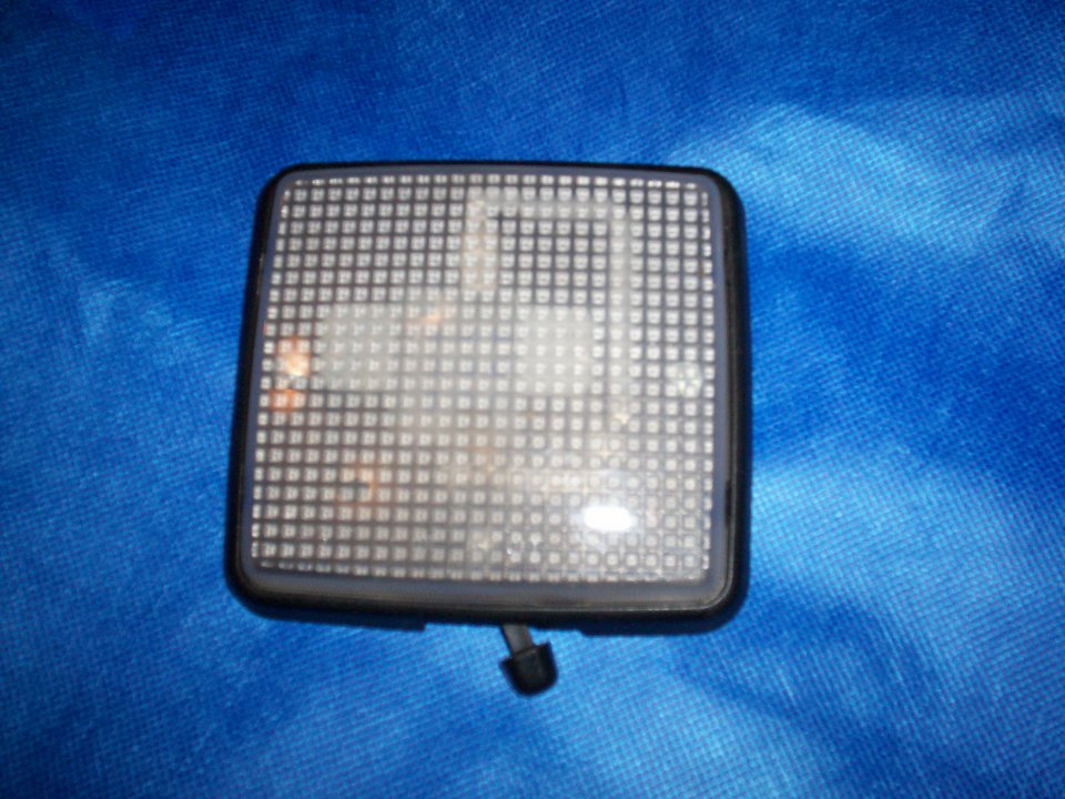

    Prius 02.JPG Light 03.JPG Light 04.JPG I just installed an overhead light in the hatch area. I connected it to the small light on the side so it works with it. The light I used is a dome light I bought at a local salvage yard. I got 2 for $4. It puts out plenty of light in the hatch area and has a switch to turn it off if I want. A very simple fix.

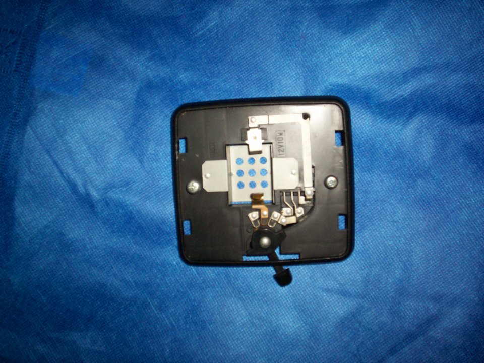

    Here is a photo of the extra light I have. You can see the 2 screws that hold the light in place. I used a flare nut behind them. Light 05.JPG

    Thats what I did. If it gives any problems i'll keep you posted. It has only been installed a couple of weeks. Here is 1 more photo that shows location better Light 01.JPG

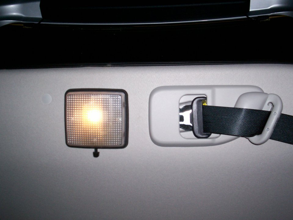

    I took the rear side panel off and spliced into the wires on the side hatch light and ran themup along the edge of the rubberstriping to the top .. It is easy to push the wires inside the trim and over head panel out of sight.
