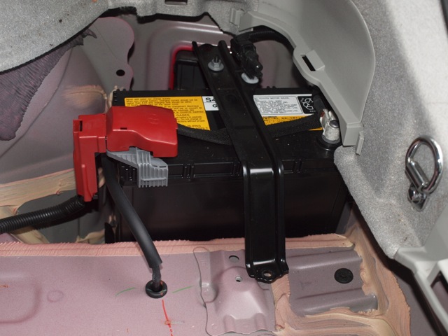

    I am planning to hook a Xantrex Prowatt SW1000 True Sinewave inverter to the 12v battery. But when I looked at the 2010 Prius cables to the 12v battery, they look very thin (10 AWG?), and don't look like they could carry much current. According to the Xantrex manual, the inverter should deliver 900w continuous, and 2000w peak. Xantrex suggests using 0 AWG cables from the battery to the inverter. But I'm concerned that drawing 900w continuous may deplete the 12v battery, if the Prius dc/dc inverter that powers the 12v battery is not strong enough to keep up with the current draw. And my concern comes from seeing those tiny (?) wires of the Prius to the 12v battery (what size are they, actually?)
    I was thinking a 150A ANL fuse on the positive cable from the battery to the inverter should protect the Prius 12v battery OK, but discover the DC/DC inverter is fused at 125A, and there's a 140A fuse built into the positive battery clamp assembly, so perhaps I should use a 100A ANL fuse from the inverter to the battery? What about peak loads above the 900w?
    So, what can I realistically draw continuously by connecting my inverter to the 12v battery? (2010 Prius)

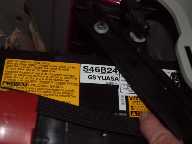

    The 2010 battery doesn't have a reserve braking capacitor next to it.
    No mention of capacity nor cranking power. Date code is May 16, 2009.

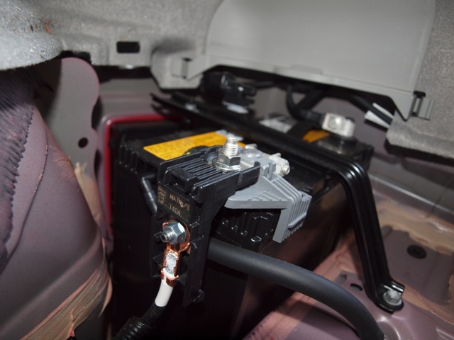

    Here you can see the 140A fuse right near the elbow of the positive side

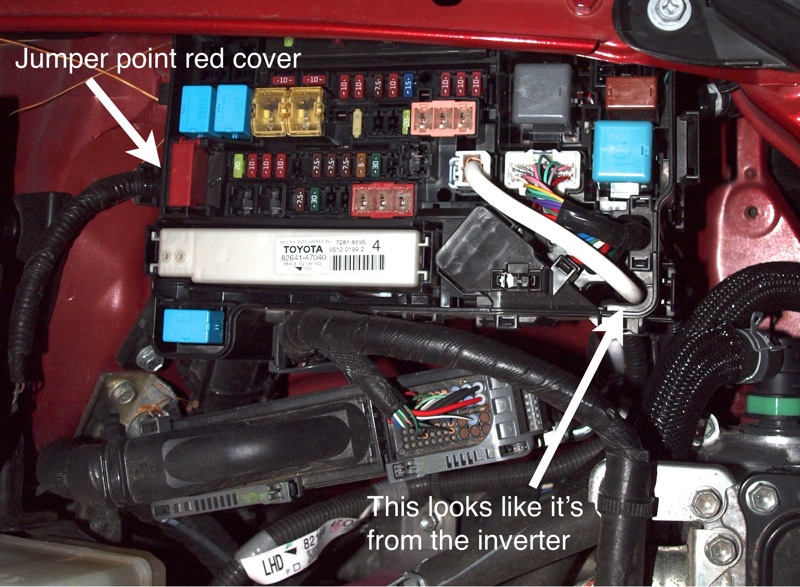

    You're suggesting to draw from the positive 12v "jumper" point in the fuse box? The owners manual clearly states that it's OK to use that to start the Prius using jumpers, but to never use it to jump another car. So I'm guessing that this post is a poor place from which to draw power.
    That's because very little power is needed to jump start the Prius. Just enough to run the computer. When it kicks in, the big power draw can be off the traction battery to start the engine.
    Most other discussions I've read go from the battery, because the battery can deliver a lot of amps for a short time (like startup surge).

    In the 2010 the 125A fusible link to the DC/DC inverter is toward the front of the fusebox. It looks like a heavy white wire, but beneath where it's plugged into the fusebox is the fusible link.
    The "jumper" is at the rear of the fusebox, covered by a red plastic cover. Which one are you talking about?

    Thanks for the info and the pictures. On the 2010, it looks a little different:
    FuseBox.jpg The thick white cable from the inverter is fused at 125A, according to the top of the fuse box. At the battery, there is a 140A fuse in the battery connection, but the wire looks like 10 gauge.
    Shouldn't I be able draw 900w from the battery connection continuously? That's around 63A if the inverter supplies 14.4v, and at least that much power to the battery. And if the power draw temporarily increases, I figure the battery will supply the additional surge for a second or so. I plan on using a 100A fuse between my inverter and 12v battery.
    If I draw current from the fuse box, I understand what you're saying about more continuous power, but I don't have room for any surge, right?
    The long white thing on mine is not clear plastic, but white. It's the integration relay. Must have replaced the fusible links.

    You might be correct that the white wire comes from the inverter. Just because the red box above the "number 4" in the big long part seems like the fusible link. It is #10 in the picture:
