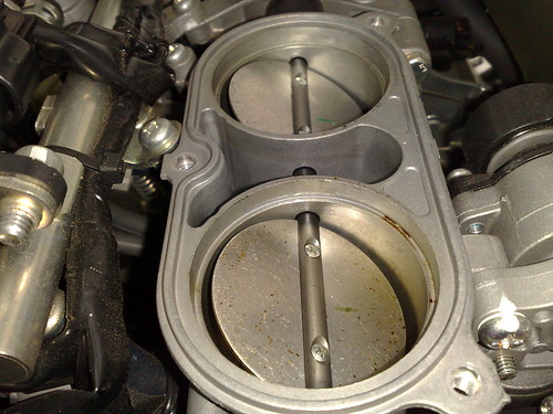

    Yes now that you mention coasting, they may well be demonstrating Pulse and Glide. And yes in a 'normal' car it would not work as well. Normal cars do not shut the engine down when coasting, so they are still using gas, normal cars have 'too much' Horsepower so it is hard to avoid pumping losses.
    If you have 300 HP and your car uses 20 of them at 60 the throttle is almost completely closed and the pistons are trying WAY too hard to suck air passed that (almost) closed throttle plate. If you have 73 HP and the car uses 20 of them to go 60 MPH, the throttle is quite a bit more open, and the pistons are sucking air passed it easily. A large part of the Prius good gas mileage is that the engine is sized to cruise, not accelerate rapidly, they add the Motor/Generatorss for that.
    You would waste a lot of energy trying to pull air through that.
