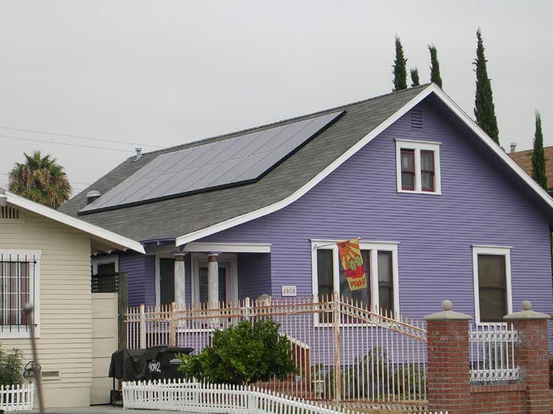

So with all the work that must have taken place to get everything mounted, you didn't once stop to take pictures? And if you did, all this time you haven't thought once to post them? What are we, chopped liver?
<div class='quotetop'>QUOTE(TonyPSchaefer @ Aug 9 2007, 11:20 PM) [snapback]493386[/snapback]</div> I have a really, really tall house. I have a before picture provided by Borrego Solar. I was promised an after picture. Sorry, but I'm not climbing on my roof to take a picture. Would you like me to take a picture of the circuit breaker box and the inverter? I'll throw in a picture of my meter for free. You are not chopped liver. Paté, maybe.

No pictures yet get the ladder out, better yet take that helecopter ride you have always wanted and bring your camera last, would be to call the news channels and tell them you have just installed solar and you get free electric to charge your prius and other stuff like that. they will be out and you can be on tv too.

<div class='quotetop'>QUOTE(priussoris @ Aug 10 2007, 11:43 AM) [snapback]493590[/snapback]</div> Ladder? You're crazy. I don't go on the roof. It's over 20 feet up there. You're going to have to be content with a shot from across the street. The webpage is now up. Are you happy now?
Nice setup! May I ask how much that setup cost? How many KW do you have up there? Are those the 208 watt panels? I have lots more questions about solar but I think I will let those questions go until I'm ready to get solar for my house. I plan on building a house that will use a combination of solar and wind but that all depends on how much everything will be and if I can afford it.
wow godiva, that looks great! i guess solar hot water might not be for you but hey, tankless is the next best thing from the sound of it.
