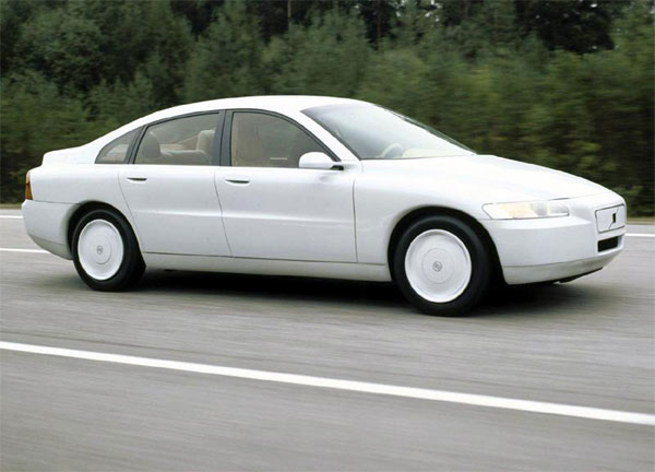

    Old News Volvo had a reheated gas turbine/hybrid prototype running around back in the early 90's. It was called the ECC and the new body it was fitted with you know as the S60-S80.
    Volvo ECC
