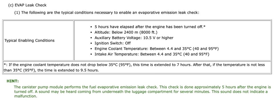

    Good info.
    I always seem to get a followup dip two hours after the first five hour interval.
    It is cold in the garage though, below 40°F, but they do say 'typical', so there's that. :)
    Could it be something else? Sure. :)

    I just verified that this is exactly what happens in my Gen 4 Prius Prime PHEV: 5 hours if the engine is cold and 7 hours if it is still warm.
    In addition, there is always a small dip at 50 minutes, which I don't know what it is.
    23:41 shutoff, 00:31 small dip (unknown), 16:41 big dip (EVAP). Note that this is an AGM battery, so the voltages when the car is off are about 0.25 V higher than with a flooded cell.
    You can also see the sub DC–DC converter in the AC charger in action in the first screenshot, between 18:00 and 20:00, keeping the battery at a float voltage of 12.92 V while the AC charger is actively charging the traction battery. The sub DC–DC converter turns off when the traction-battery charging ends. This is the only difference between Gen 4 and Gen 5—the latter does not have a sub DC–DC converter in the AC charger and instead activates the main DC–DC converter during active traction-battery charging.
