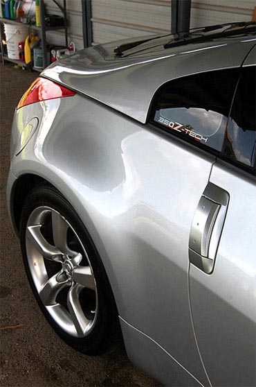

    A car finished in Zaino.. note the glossy, plasticky look...

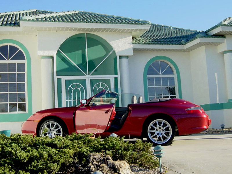

    A Zaino finished Porsche...
    and a Zaino finished Firebird....
