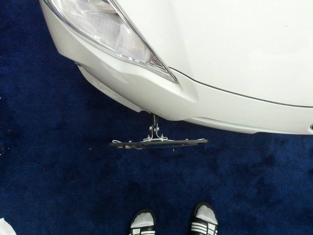

    Disclaimer: I am not responsible for anything that comes as a result of the modifications found in this thread.
    Seeing as how I am poor, but don't want to settle with drilling my bumper, I had to dig around for some DIY tow hook license plate mounts. What I found was this (all credit really should go back to the OP of this thread): Tow hook License plate mount DIY - E46Fanatics
    Aside from the hardware and zinc plated thingamajig, the only thing you need is the tow hook bolt that COMES WITH YOUR CAR. You can find the tow hook bolt in the tool bag supplied with the car in the spare wheel compartment.
    I don't even have a plate to try it out yet, since my C is only about 2 weeks young :D. I'll upload updated pics when the plate comes in.

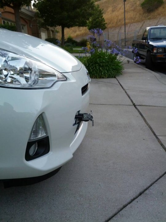

    Pic 1: Overview of the mounted bracket.

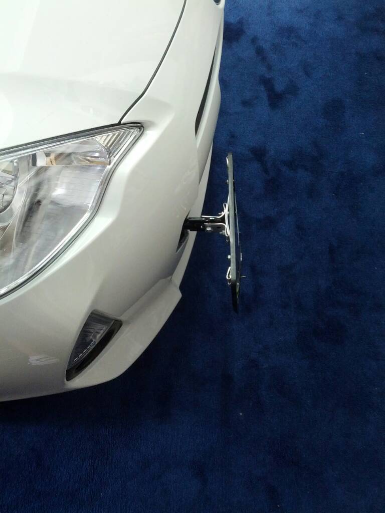

    Pic 2: View from top angle for general design of bracket.

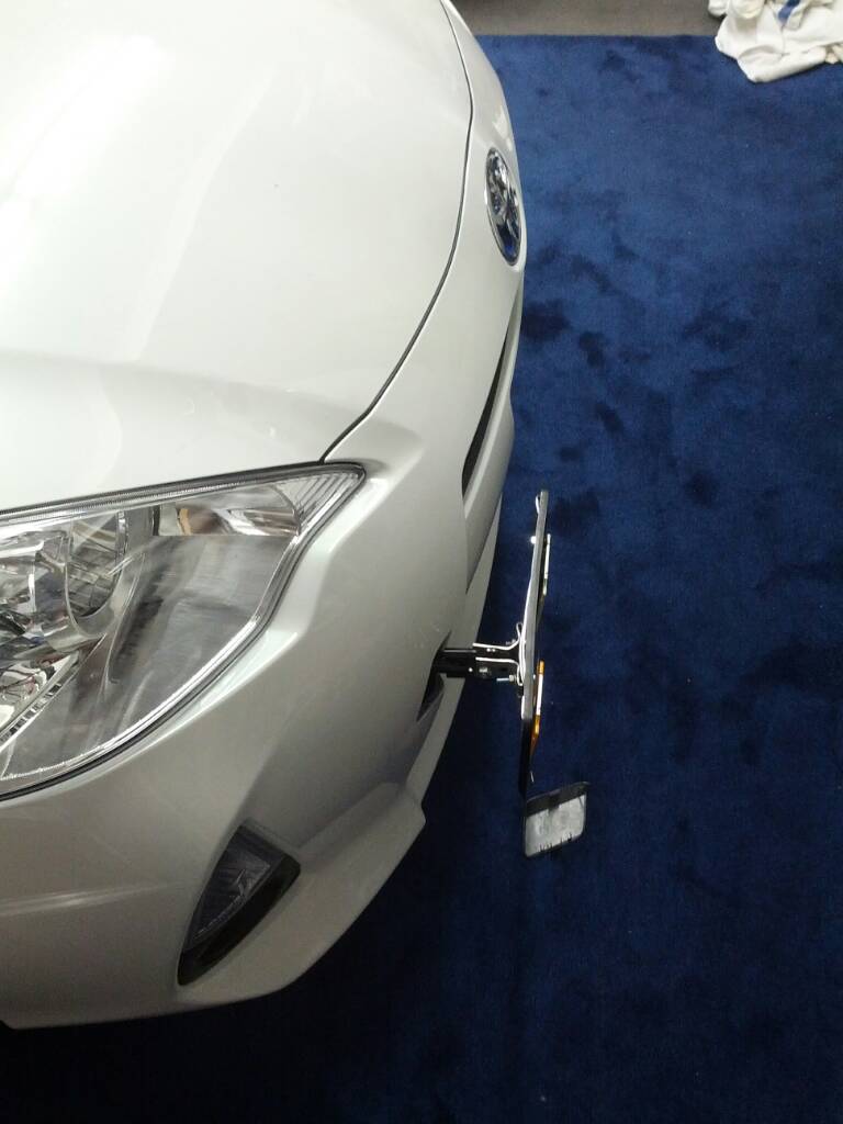

    Pic 3: Side profile shot to demonstrate how much the plate would stick forward of the bumper.
    Note 1: The hardest thing to do was make the "T" section, as bending such a small piece of metal isn't easy with so little leverage. Just use a hammer and some sort of ledge to get the bends you need. My T section was 11 holes long (does that sound awkward to anyone else??). Aside from that, just bend the pieces to your desired angles to make it fit the plate.
    Note 2: The included tow hook bolt did not mount exactly at the desired angle (you'll understand what I'm saying if you try it). You may need to trim some of the threaded end to get it snug at the right angle.
    Update:
    Update 2:

    Thanks! Only thing I'm worried about is possibly blocking the fog light beam, but I can probably do some fanangling to get it right if that's the case. Also, I might add some sort of rubber shroud to cover all the funky business at the tow hook eye.

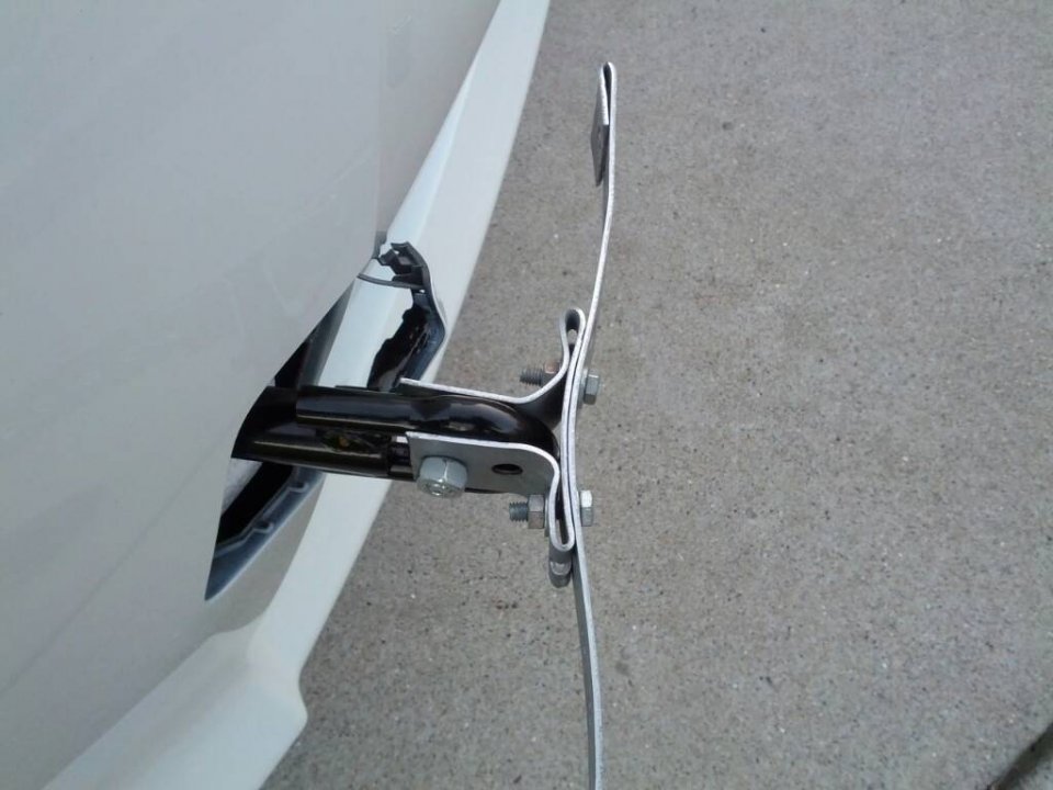

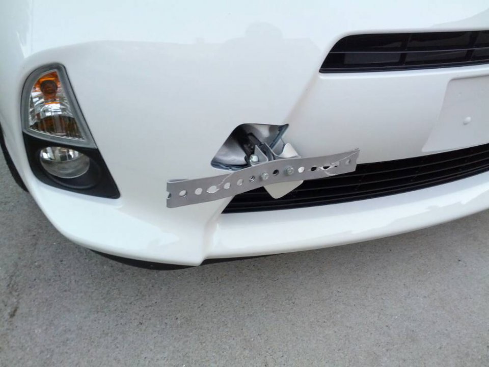

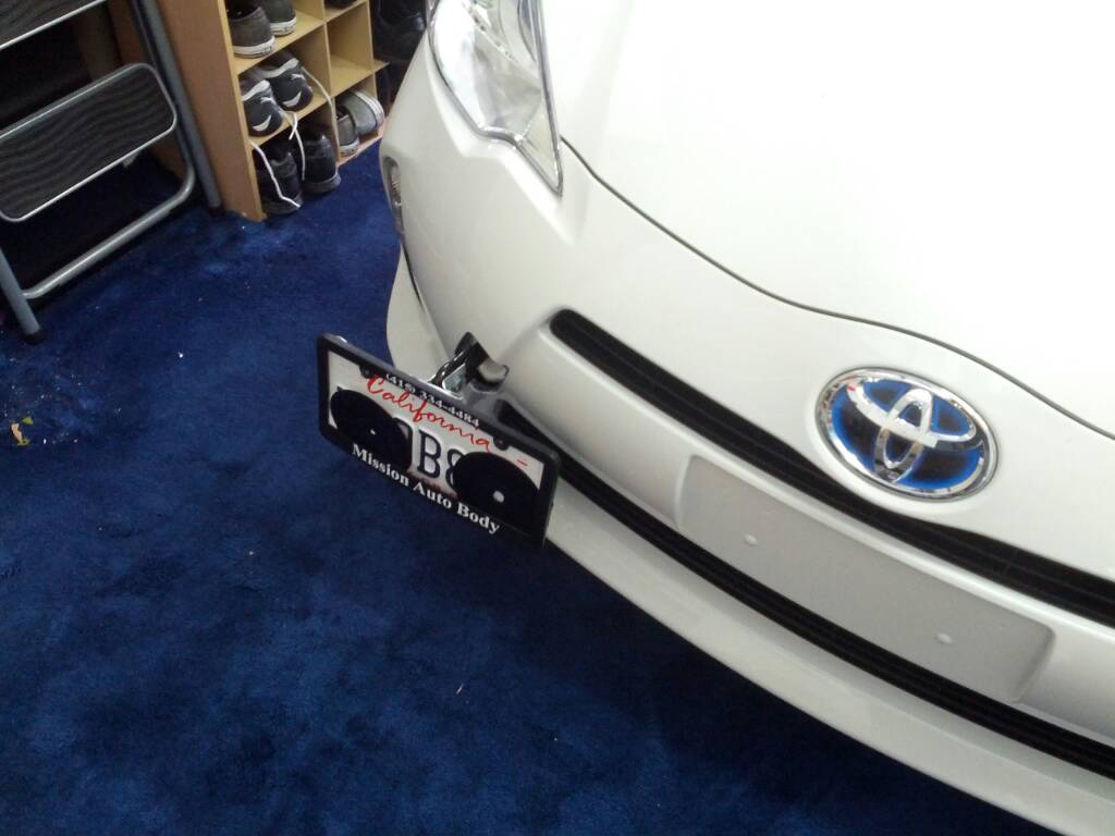

    Updated pics!
    If I can be totally honest about my result, I don't actually like it as much as I thought originally. Refer to the pics above. Although one side of the plate is very close to the bumper cover, the passenger side of the plate simply sticks out way too far for my taste. It looks like it would get hit or scrape against things that otherwise would have cleared without a problem.
    Does anyone know if (in CA) it's illegal to mount the license plate at an angle? I basically want to get the plate to mount as flush as possible with the curvature of the bumper, which means it would have to be at an angle. I've seen a few Lancer Evo's with the angled mount, but I don't want to jump off a bridge just because everybody else does.

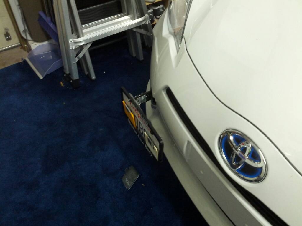

    Second update. Shifted the plate more towards the center. Still not really satisfied.
    Thanks for the input regarding the legal stuff on the mount. As of now, I'm planning to just drill the bumper :(. Any tips on how to drill it properly??
