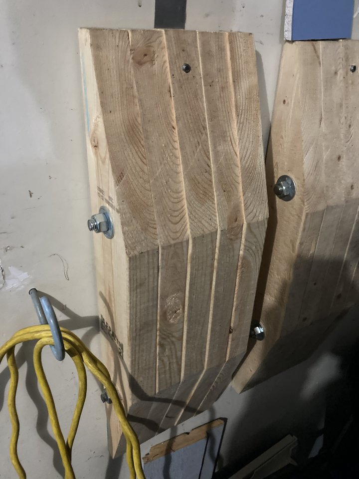

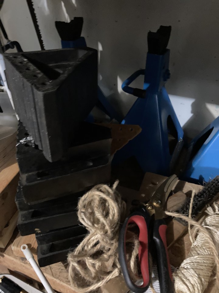

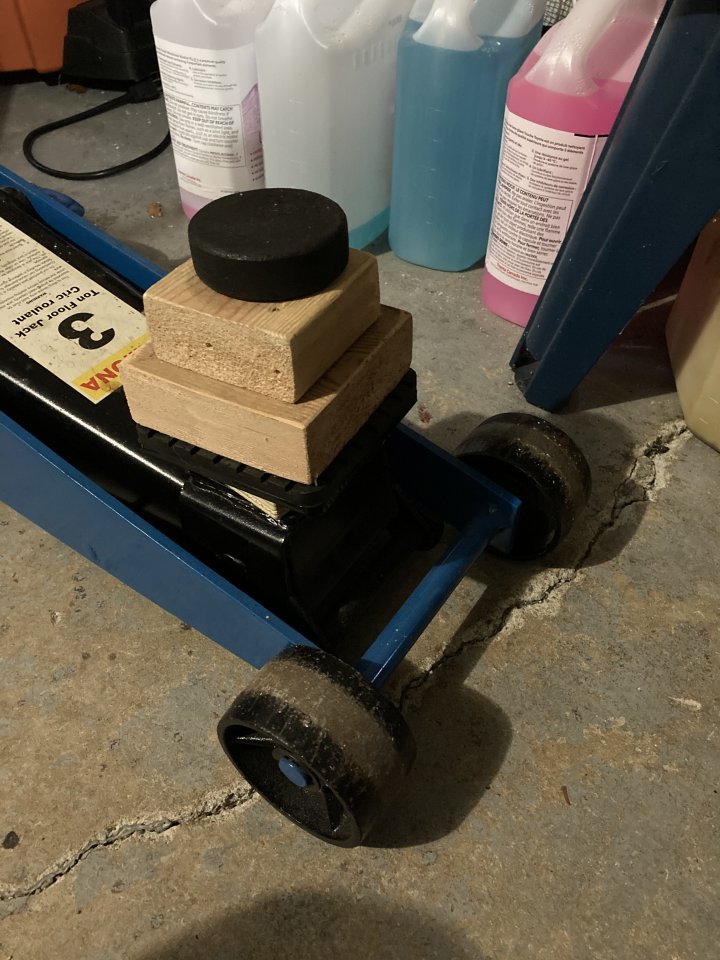

    Anyway, some stuff I use:
    (The two wood pieces are keyed together)
    (heavy, rubber wheel chocks, always good to have on the end not being raised, fore and aft of each wheel, tapped in like wedges)

    that looks like a hockey puck, eh? :cool:
