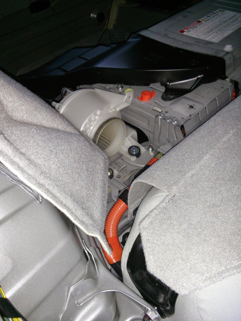

    There are lots of threads on this but no resolution other than dirty fans.
    Our fan is pretty clean. Before re-assembly it will be blasted with ~100 psi from an air compressor. Driving around like this is fine for a while to help diagnostics.
    How noisy is normal? This is the first time I noticed the noise.
    We've owned this silver 2011 Gen 3 from new and it now has 37K miles after about 3.5 years. Today it's ~70F in Atlanta, so not hot compared to how it will be soon. We had the s/w recall done about six months ago and I've possibly not driven the car since (have a few cars).. my wife drives it most days and did not notice probably due to music but I felt it was very loud like there was hole in the side of the car (first thought was some vent to the outside became stuck open but the vent near the axillary battery is fine).
    Is there a way to read the fan speed via Android Torque and Bluetooth OBD?
    Should I disassemble the entire length of the venting? Might there be something inside there causing a blockage?
    The Auxiliary battery hooked is up to my CTEK charger now. It read 12.7V so is likely fine.

    That fan should not be loud with so few miles on it. Do you have sensitive hearing? Too bad you're out of warranty to have it checked for free.
    Since you're not the main driver of this car and your wife doesn't notice it......it would just be best to leave it alone.

    sounds like your hybrid battery may be going further south than atlanta. i hope not, but at least it's under warranty.

    If you blow powerful compressed air at the fan, and allow it to spin very fast, you can damage the electronics connected to the fan. The fan spun by compressed air generates high voltage.

    OK.. driving around with all the covers off the fan only came on a few times. None as noisy as yesterday though it looked to be spinning fast at times.
    I am just going to dust it off with compressed air and re-assemble assuming it was normal behavior.
    The car can last for ages in slow moving traffic on just the traction battery so it's likely fine.
