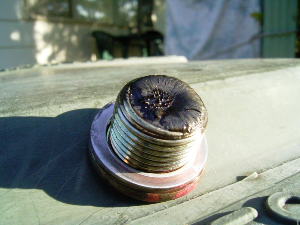

    For regular oil changes; NOT SO MUCH benefit, because of the filter and the frequent oil change.

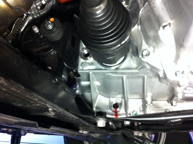

    However, the transaxle can do for a magnetic drain plug, which Toyota eliminated in all Gen III Prius models.
    Photos of magnetic drain plugs removed from Gen II magnetic drain plugs show a lot of steel and iron particles stuck to them.

    I've found that, while the engine oil drain plug captures some particles, it is not very much.

    Exactly; the transaxle has NO filter or screen.

    Due to the long service life of fluid in transmissions and transaxles, a magnet in the pan or in the drain plug is a cheap effective option.
    Every Japanese car that I have owned since 1987 had a small five cent ceramic magnet in the pan.
    When examined, they had iron or steel particles in it.
    Particles in the fluid acts as an abrasive on the metal gears and modifies friction on the clutches.
