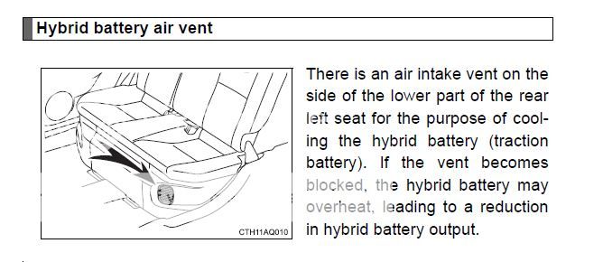

    Make absolutely sure you don't have the rear seat vent for the hybrid battery obstructed!
    Edit: assuming vent is in the same location on the C as previous Pri.

    This is a picture off the net showing the vent below the driver side rear passenger seat.

    This is were the manual says the vent is. Be sure to very it does not have an obstructions.
