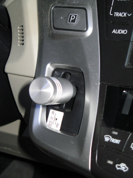

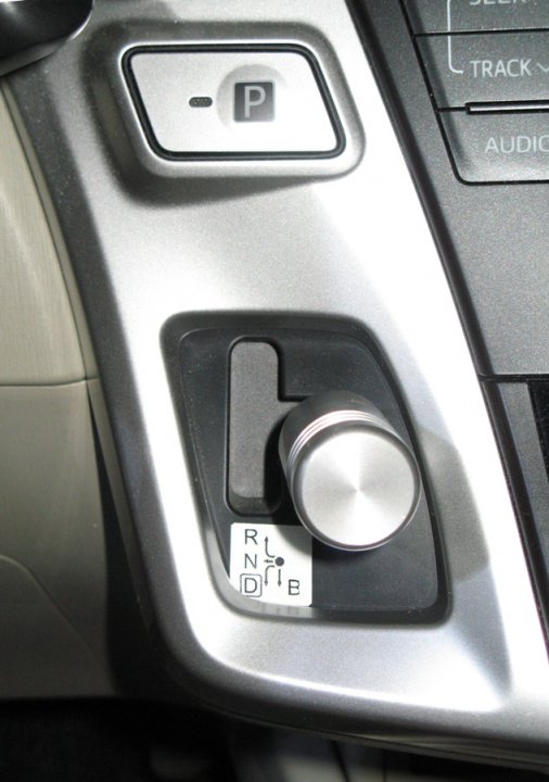

    This is what I mean. The "v" shifter shaft is longer than the shaft on regular Prius shifter. I had to make may trial an error drilling into the shift knob to get the depth of the hole right.
    Due to production parameters, it would be very difficult for Razo to get the knob to "lock" in the correct position, should the knob's top be engraved with the correct shift pattern. That's why the provided a sticker. I you notice the sticker is made for a right hand drive shifter.

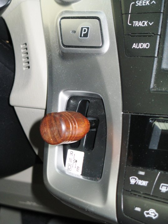

    I got some of that Arizona Sonoran ironwood today, and I am really impressed.
    Like true Lignum vitae, Brazilian rosewood, Arizona ironwood has become a protected species. I really don't know how long it will be available. It machines wonderfully. I've heard that some of the stuff is 1600 years old and does NOT decay much at all in the desert.
    Most of the ironwood available is imported from Mexico and harvested by the Seri Indian Tribe. The wood is a protected species in the United States.
    It is used in custom knife handles and custom pistol grips, as well as custom made pens.
    So, this wood will make a really nice shift knob which is easy on the hands both in the Summer and the Winter.
    I am surprise on how well it threads with machine tools. I thought it might require a metal insert, buy I NOW don't believe so. I'll keep everyone posted as I proceed.
