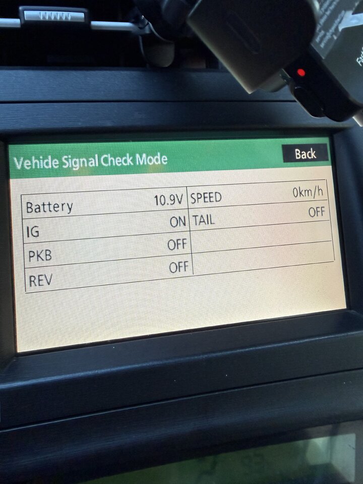

    I also just found two major issues:
    1. My 12V battery is reading 10.9Vin accessory mode (Diagnostic Menu).
    2. I cleaned the MAF sensor with a household dry cleaner rather than CRC.
    I'm getting 40+ MPG on the highway, but only 34.7 MPG in the city (Avg speed 26 MPH). Could the 10.9V battery be keeping me out of S4/EV mode in the city, or are these 225 Bridgestones just too heavy?

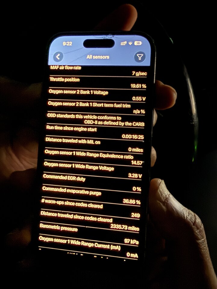

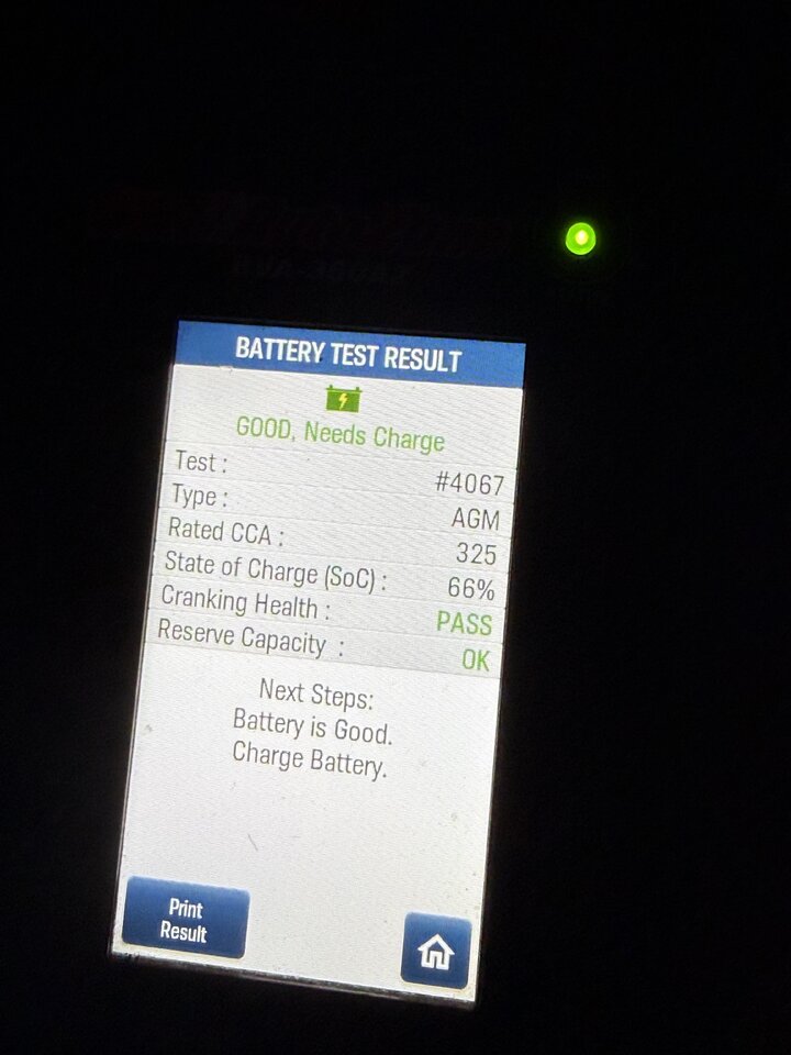

    UPDATE: 12V Test Results and OBDII Live Data (MPG Drop 2010 Prius)
    Hi everyone, thanks for the previous advice. I have some data updates and would love your thoughts:
    1. 12V Battery Status:
    • Resting Voltage (Home): I measured 10.9V in accessory mode.
    • AutoZone Load Test: They rated it as "GOOD, Needs Charge."
    • State of Charge: 66% (325 CCA).
    • Ready Mode Voltage: 13.2V to 14.2V.
    • Question: Even if it passed the load test, is 10.9V resting/66% SoC enough to keep the ICE running more frequently in city traffic (Avg Speed 26 MPH)?

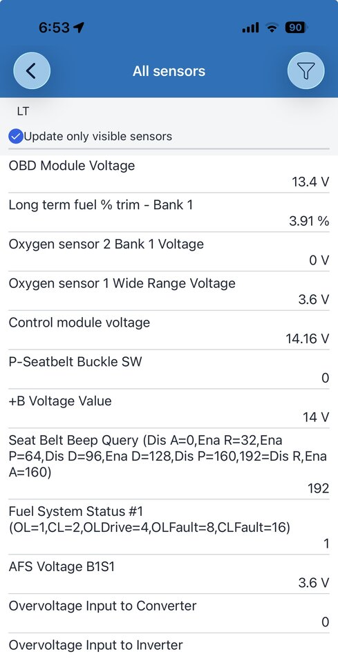

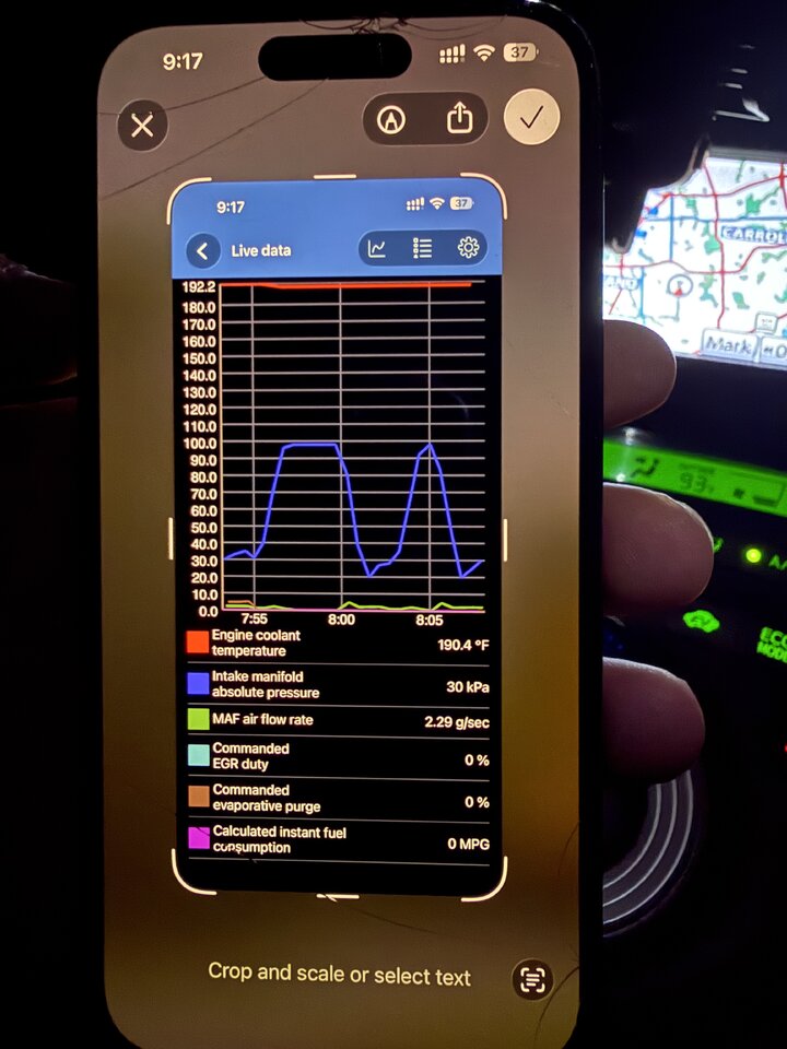

    2. OBDII Live Data (At Warm Idle in Park):
    • Coolant Temp: 190°F - 192°F (Seems healthy).
    • O2 Sensor 1 Equivalence Ratio: 14.57 (Seems perfect).
    • MAF Air Flow Rate: This is inconsistent. I saw it jump from 2.29 g/sec in one test to 7.0 g/sec in another, both while at a warm idle in Park.
    • Note: As mentioned before, I cleaned this MAF with a household dry cleaner. Does 7.0 g/sec at idle suggest the sensor is over-reporting and over-fueling?
    3. Tires & Math:
    • Confirmed I am on 225/45 R17 Bridgestone Turanza QuietTracks.
    • My previous tires were 215/55 R17 (oversized).
    • I now realize the 5% diameter drop means my current 34.7 MPG display is under-reporting actual distance, while my old 40 MPG was likely over-reporting.

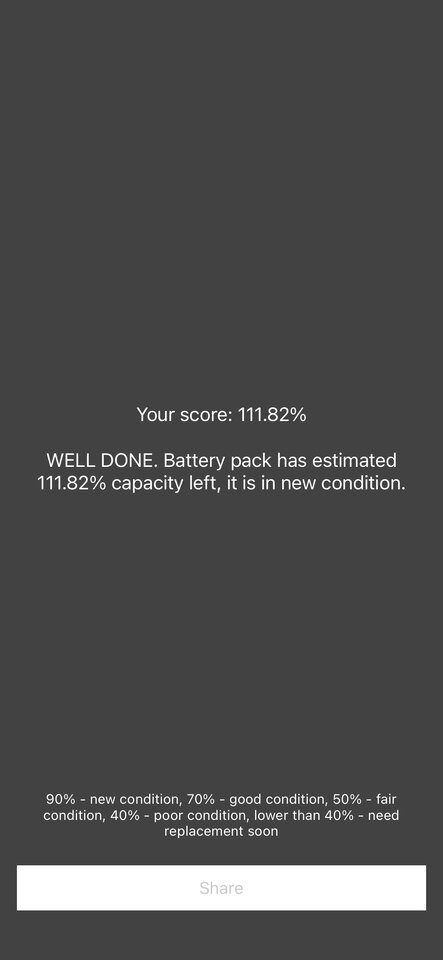

    The big question: With a healthy engine (192°F) and healthy hybrid pack (111% capacity), is this 5 MPG "loss" simply the physics of the wide 225 luxury tires combined with a "lazy" MAF sensor? Should I replace the MAF despite no codes?
  11. ASRDogman
    ASRDogman Senior Member
    May 29, 2018
    8,037
    4,074
    Did you charge the "new" 12v battery? They sit on the shelf loosing charge over time.
    It is always best to charge it for several hours before installing.
    You have oversized tires. They rotate slower, so less mileage, and less mpg.
    It is always best to use the size/type of tire that the manufacturer calls for. Size wise.
    Brands vary....
    I believe you've resolved your issue. (y):whistle:
    Load testing the 12v battery for the Prius is pretty much useless, unless it dumps the voltage
    instantly or very quickly, which is showing the battery is bad.
    The 13.2-14.2 is because the inverter is charging the battery.
    The 10.9 is showing the battery is dead.

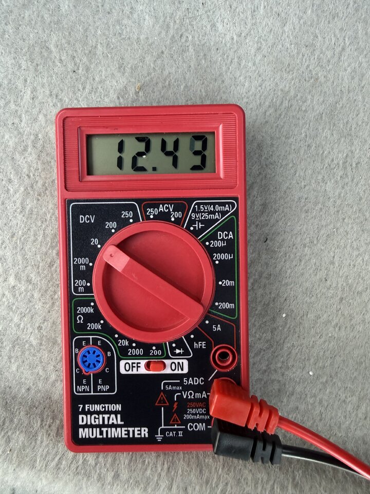

    Thanks for the detailed feedback, ASRDogman. I want to clarify my 12V data points to be exact:
    1. The 12V Battery:
    • Resting Voltage: My multimeter shows 12.42V when the car is completely off.
    • Under Load: When I put the car in 'Ignition-ON' mode (engine off), the car's diagnostic menu shows it dropping to 10.9V - 11.1V.
    • AutoZone Result: Their machine (on AGM setting) said 'GOOD, Needs Charge' with a 66% State of Charge.
    • It seems the battery is healthy at rest but has low reserve capacity under load.

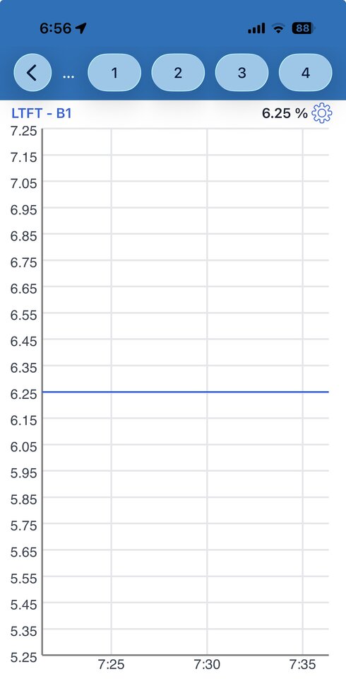

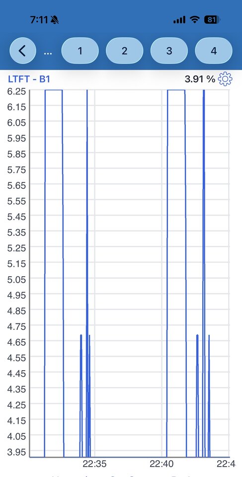

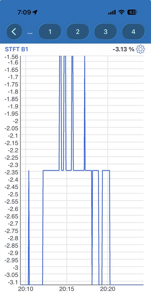

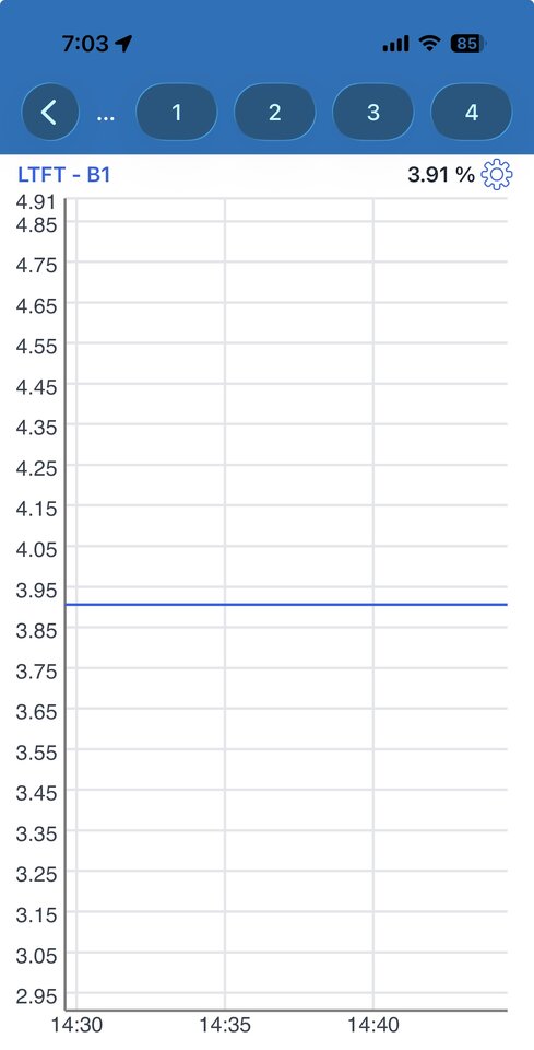

    2. OBDII Live Data (Steady Warm Idle at 190°F):
    • MAF Air Flow: Steady at 2.29 g/sec .
    • Fuel Trims: My LTFT is 3.91% and STFT is -3.13%.
    • Hybrid Battery: Testing at 111.8% capacity.
    3. Tire Correction:
    I confirmed the current size is 215/50 R17(Bridgestone Turanza QuietTracks). My previous tires were 215/55 R17.
    • The old 215/55s were 6.9% oversized, making my old 40-43 MPG reading very 'optimistic' due to odometer error.
    • The current 215/50s are 3.7% oversized, so the display error is smaller now.
    I have Reset Trip A and pumped the tires to 42/40 PSI. Based on the healthy 2.29 g/s MAF and 3.9% LTFT, it looks like my engine work was a success. Is the remaining MPG 'drop' just the reality of these heavy Bridgestone tires?

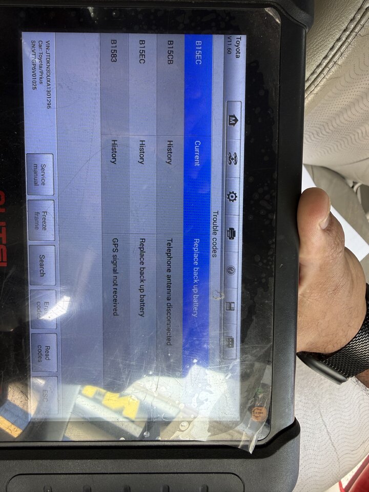

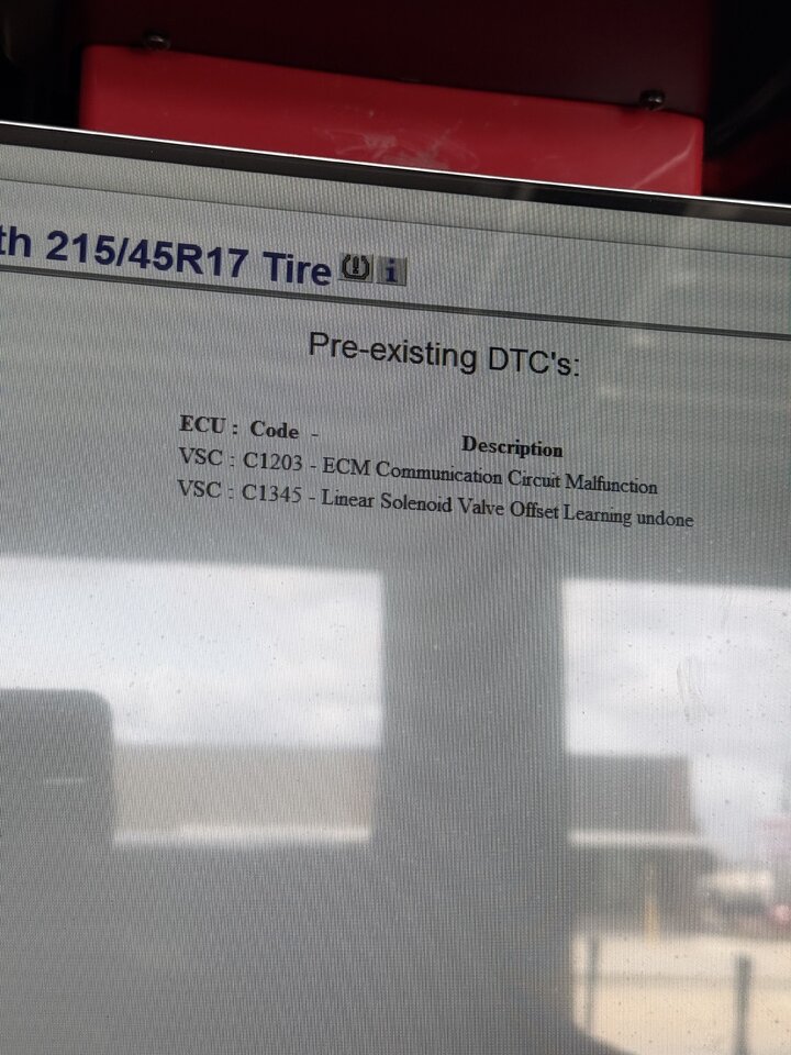

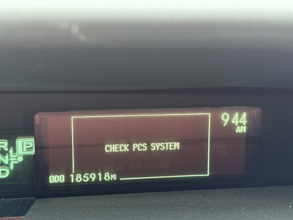

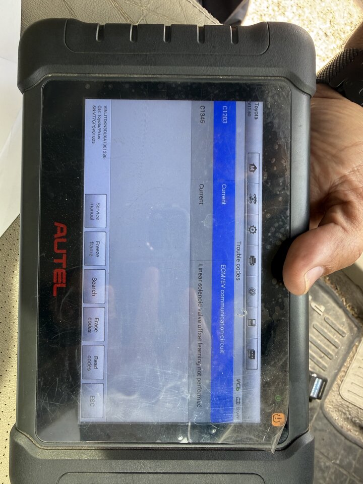

    I also want to add that a few months ago, right after my alignment, several dash lights (VSC/ABS) popped up. I had to use Techstream to perform a Zero Point Calibration and clear the codes. Given that my battery is currently resting at 10.9V under load, I suspect the battery was so low during the alignment that it triggered those communication errors.
    Does this confirm that my 12V is the 'hidden' reason the engine is refusing to stay in EV mode in the city?
  14. ASRDogman
    May 29, 2018
    8,037
    4,074
    How old is the 12v battery? Have you fully charged it, with an AGM 5amp or less charger?
    If it's 5,6,7 years old, I'd say it's getting weak....
    The alignment place likely left the car in ready mode, not running, which drains the battery quickly.
    A weak/low 12v battery will cause issues....
  15. Naveed Shaek
    Naveed Shaek New Member
    Jul 4, 2026
    18
    Plano
    Thanks again, ASRDogman. I checked the sticker and it says A23, so the battery was manufactured in January 2023. It is about 3.5 years old.
    I haven't put it on an external charger yet, but as you suspected, the shop load test yesterday said 'GOOD, Needs Charge' with a 66% State of Charge. My home multimeter shows 12.42V at rest, but it still drops to 11.1V as soon as I put it in IG-ON mode.
    Regarding the tires, I confirm they are 215/50 R17Bridgestone QuietTracks. I moved to these from 215/55 R17s. I’ve reset Trip A and bumped the pressure to 42/40 PSI.
    My engine data seems very healthy: LTFT is 3.9%and MAF is 2.29 g/sec at a warm idle (190°F).
    Do you think a 3.5-year-old battery at 66% charge is weak enough to be my main MPG thief in the city, or should I be looking elsewhere since the engine trims look okay?
