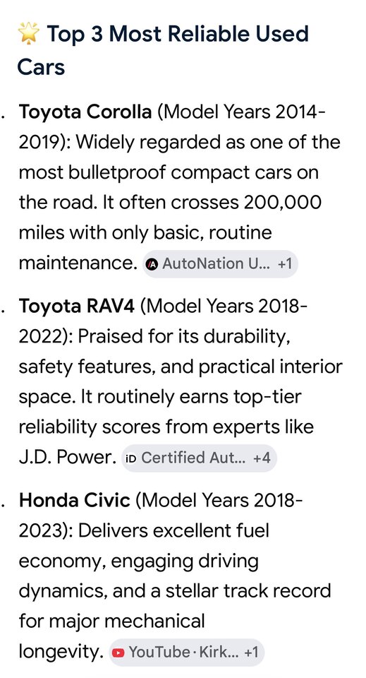

    Depends what low budget means in your case. Obviously mpg is a factor but I would not buy another Prius v 2012-17 or a standard 2010-15 Prius. They all are getting old and can have three or more multi thousand dollar failures.
    Plus everybody and their dog are buying Prii now with high gas prices which is artificially driving up prices. Anyone with a good one is not selling.
    My used car upgrade from a 2012 Prius v would be a Venza Hybrid or a 2020 or newer Rav4 or Camry hybrid. Again those prices are likely to be jacked up. You get more power, a better ride and advanced safety features in each of these. Worth a financial stretch assuming you need a safe and reliable car.
    A new car lease can be a low cost way to upgrade especially with a Toyota that has high residual value.
    If you trade your car when its running right you may do ok. I would not private sale it to anyone and especially to anyone you know.
    If you really need low cost, just about any conventional engine Camry, Avalon, Corolla, Rav4 or some CRVs, Accords and most Civics would be possibilities.
