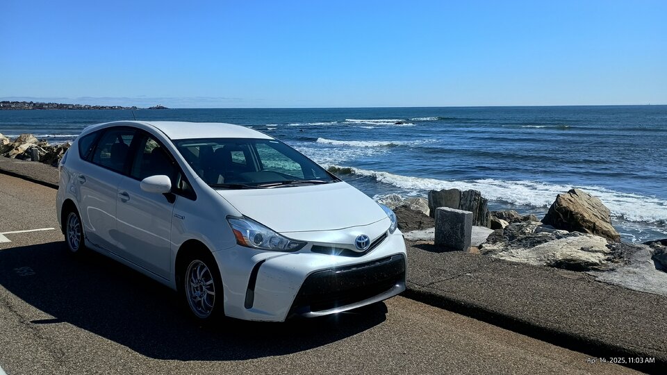

So I did the HG , new water pump and thermostat. No longer getting over pressurization in coolant overflow and back to normal coolant temps during driving. BUT this motor is worn out and showed signs of neglect. Cylinder bores had shiny areas . All piston tops were ok, and traveled to top of cylinders evenly. So I'm researching options. Brand new short block. Used long block. Local sourced long block vs JDM long block? I'm in Maine USA so far away from California. The body, paint and interior all in very good condition.
