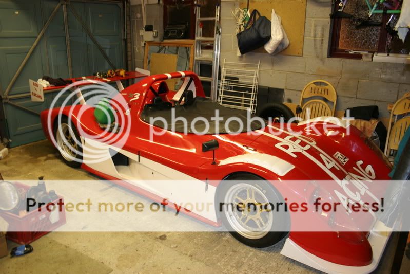

    I dony know hottit, thats just the way he is. afterall would you argue with a guy his age.... :)
    he is unlike me i am sedate in my driving style.
    these are my toys
    Radical SR3 track use only
    BMW Z4 - weekend car
    Dario

    om goodness. That Radical is a dang fast car (saw it on Top Gear). Can't argue with linearage either lol.
