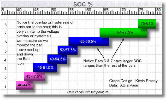

    I'm pretty sure the Gen 2 MFD only has 8 bars total for displaying Hv battery status.
    If SOC is ~40%, only the bottom 2 bars will be on and will be purplish.
    If SOC is ~>40 and <~62% up to 6 bars will be lit and will be bluish
    If SOC is >~62% through ~80% the 7th and 8th will come on and all bars will be green.
    8 bars and 62% SOC sounds off a bit to me. At 62%, it should be either 6 blue bars or barely hitting 7 green.
    This is also based on Techstream readings, not HA. Idk the accuracy HA, but you would think it reads directly from the car ecu.
