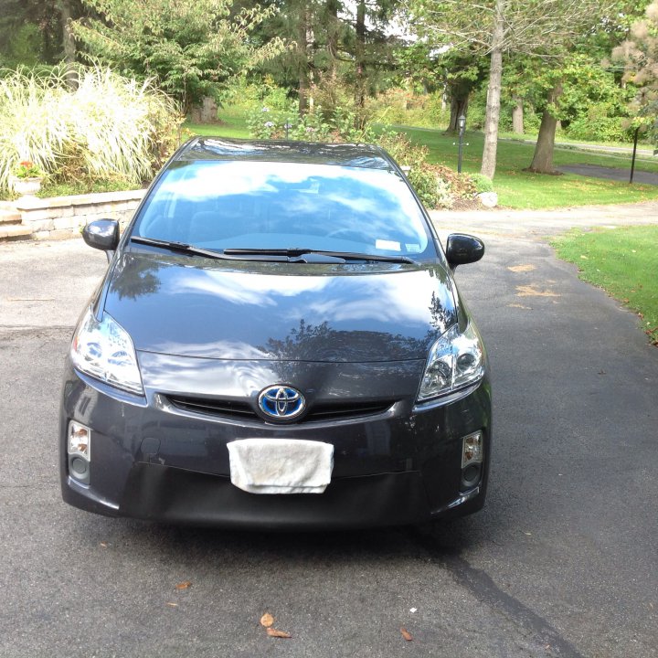

    I thought I would try a change from my usual pipe insulation grill block this year.
    One more from the front View attachment 57666

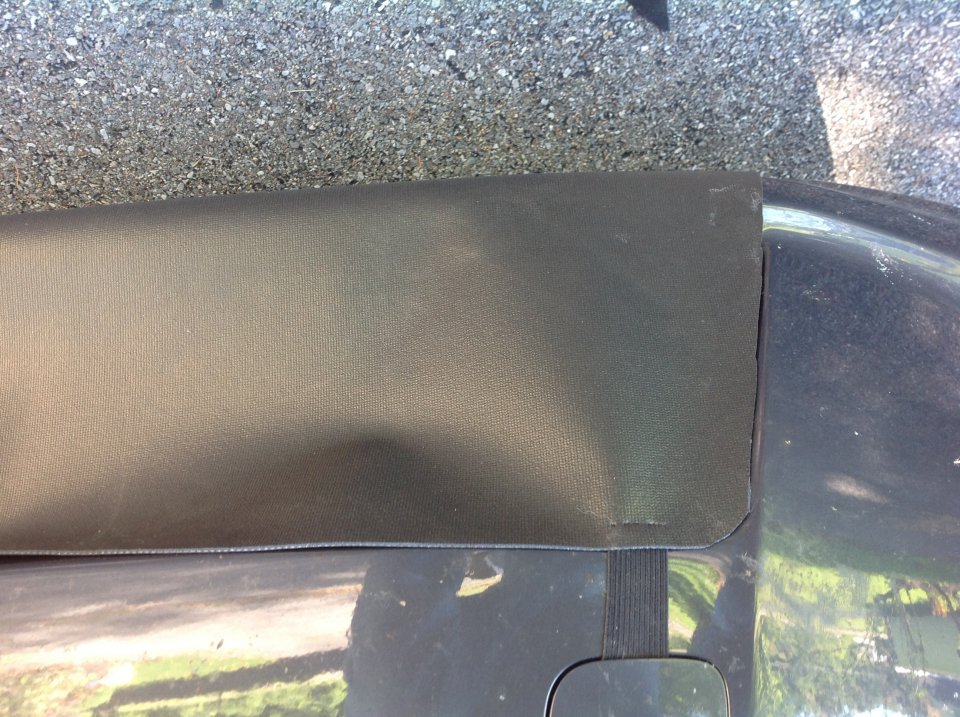

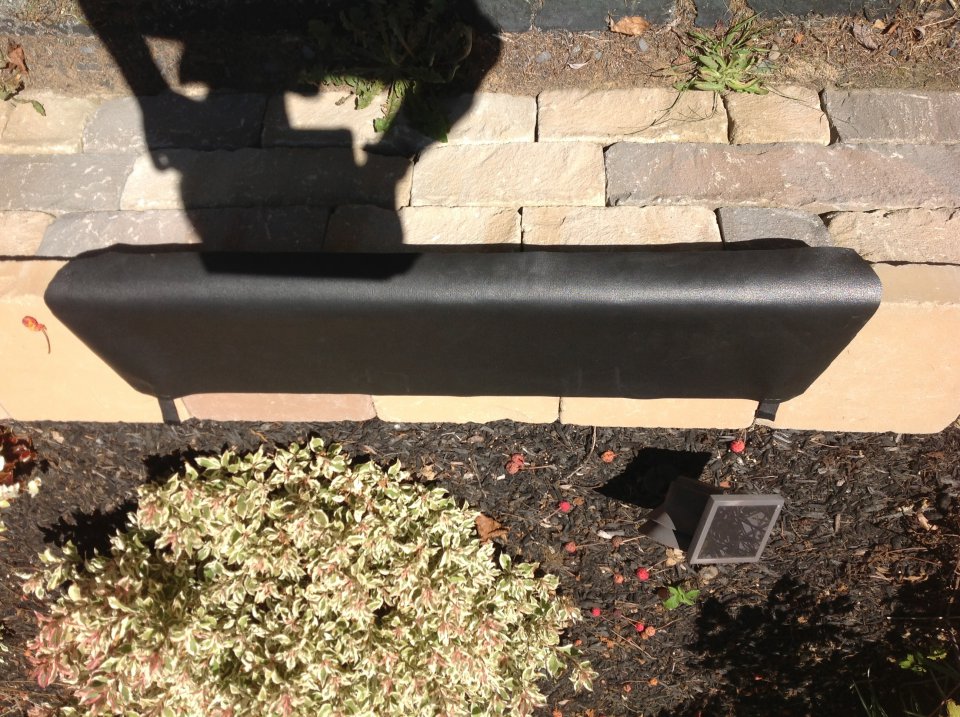

    By mid October it is cold enough here that blocking the airflow from the lower grill speeds up the warmup cycle and reduces the internal combustion engine firing up to provide cabin heat. In the past I have used the typical pipe insulation but thought this would be easier to install and might provide a little aero benefit.
    It will be put in place in a few weeks and will stay on until April.
    Sorry about the photos. For some reason my ipad picture posts end up flipped even though they are correct on the ipad.
    I was able to tuck this shelf liner material behind the license plate holder and under the front lip of the spoiler.
    Two little Velcro strips below and the elastic up front holds it in place.

    Coming from a racing background and doing a lot of R&D on grill blocks I'm going to tell you that you are wasting your time with this, unless you built a more aerodynamic nose cone out of a rigid material.

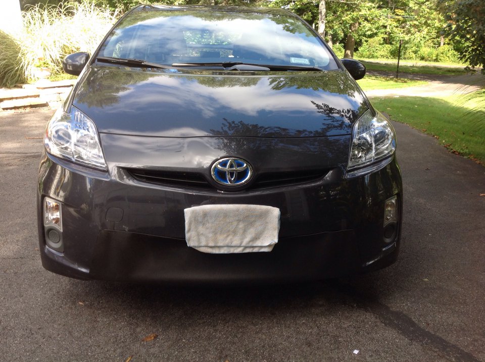

    A bit better shot and hopefully not upside down. It is 53 degrees out here today so I took it for a test run. All seems well image.jpg image.jpg image.jpg

    You don't need to also block the upper grill?

    On the Gen III the theory is you don't want to block upper air vents as that cools the inverter. You want the inverter to run as cool as possible.

    Might need two more straps. One on each side of the license plate frame, going up to the upper grill, lower edge. There might be some flapping in the upper middle area at higher speeds.
    Or maybe loop a strap up around the license plate frame.

    The 'hole' at the vent area seems creating a drag. As other said, get rid of this 'hole' will enhanced the aerodynamic effect.
