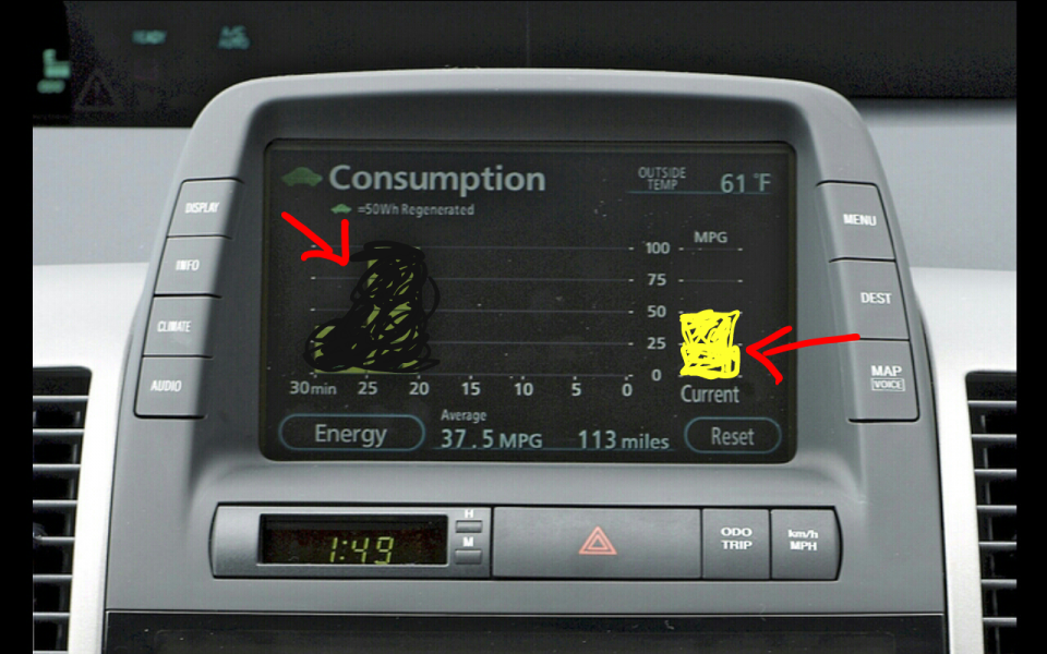

  17. Farjad
    Farjad New Member
    Jun 1, 2014
    this kind of display i see whenever i drive . This isnt my pic. I see this current graph which changes accordingly to my speed/power. But nothing displayed against the time coordinate of graph i-e 5, 10, 15, 20.
  18. uart
    uart Senior Member
    Sep 7, 2009
    4,220
    1,209
    Australia
    Wow that's weird, I've never heard of that particular failure before. There have been some cases where the display fails completely due to bad solder joint, but I've never heard of one doing everything else properly except the time graph. Hopefully someone else can help, I've got no idea on that one. (n)
