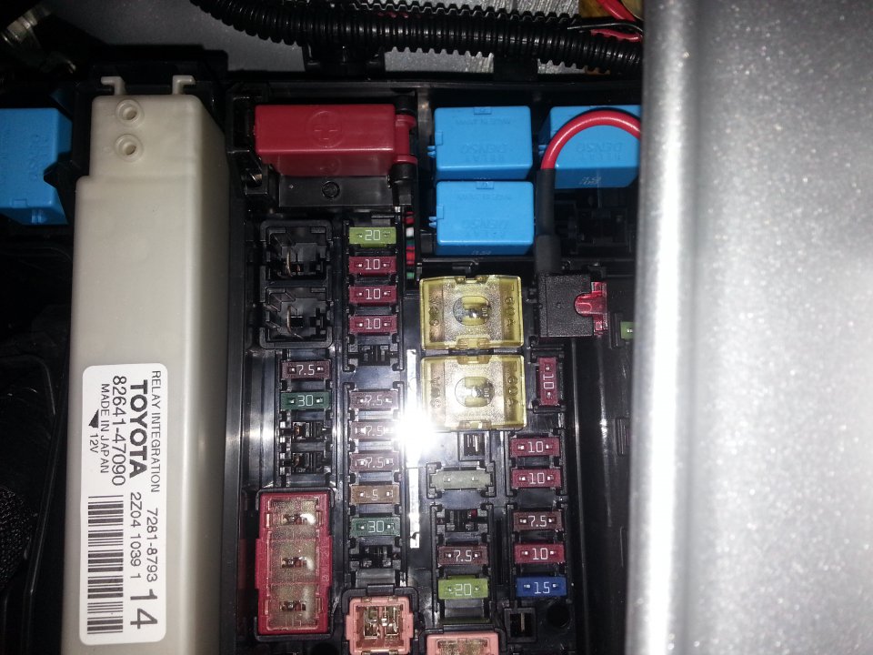

    Do you have a multimeter? I know some have tapped the windshield wiper washer motor wire for acc power.
    I think others have tapped the fuse for the inverter cooling pump in the engine fuse box.

    If you have a fuse tap and want to use power from the fuse box, then test the small metal terminal on both sides of the fuse for the inverter cooling pump with both power off and in Ready mode.
    If you don't have a fuse tap, then test the wires going to the windshield wiper washer pump in power off and in Ready mode.
    Once you have located the wire or fuse that's hot only in Ready mode then tap that for your relay trigger wire.

    I've added a "ADD-A-CIRCUIT BLADE STYLE FUSE TAP" into "IGCT NO.3" with an 10A fuse.
    Is been close to two months now, I have no issue.
    The DRL Switch won't come ON when in ACC mode, DRL only comes ON when in READY mode.

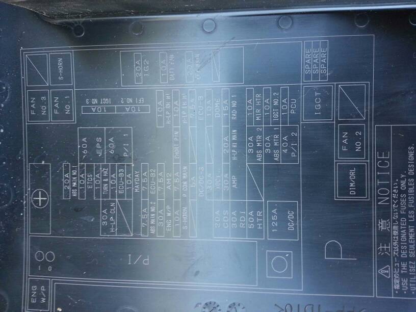

    If you want ACC (rather than Ready) power, tap into the fuse box at #25 or #26. You don't necessarily need to use a add a circuit thingy. Just stick the wire into it ensuring it doesn't bridge under the fuse.

    25 PCU
    26 IGCT No. 2
    It's found in the Do-it-yourself Maintenance section of your owners manual.

    Lower right quadrant of your fuse box.

    Can someone elaborate what fuse 34 is? What the heck is the "cooling system" IGCT No.3, i see the battery cooling fan is fuse 39 for the 2010.. I only need about 1amp for the DRL's and figured a "add a circuit" and a 2A fuse should work.. I just like to know what I am adding on to.
  16. xliderider
    xliderider Senior Member
    Apr 19, 2012
    8,016
    3,198
    Honolulu, HI
    The fuses are labeled on the cover of the fuse box.

    I did this mod to our Prius Plug In and suggest that you do not tap into fuse #26 IGCT No. 2 (if you want to turn on ACC) as this will turn the LED DRLs on when you plug the charger in!
    I will be switching over to having the DRLs turn on when Ready instead (IGCT No. 3) just because there is no point in having the lights on unless I am actively driving.
  20. FuelSipNDip
    FuelSipNDip New Member
    Sep 23, 2013
    Ok, scratch that. I switched it over to IGCT No. 3, and it still turns on the DRLs when I plug in the car. I proceeded to switch the fuse over to EFI No. 2 (right next to IGCT No. 3) and voila!, no more DRLs lit during charge. The only thing is that the DRLs turn on with ACC power rather than Ready Mode; I am ok with that for now. I didn't feel like testing circuits last night.
