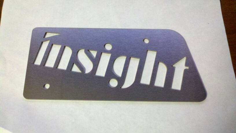

    I have a custom made dead pedal for my Insight. The word "Insight" is cut out of the metal dead pedal. I want to fill in the letters with something like a liquid plastic that will harden.
    I dont know what I'm looking for so I hope some of you that are in to crafts might know what I need. I want it to be hard an durable. Does not matter if its gloss or flat finish just as long as it will last. Also must come in colors such as white, black and red.

    The letters are cut all the way through. I can put a backing on it. I have some white vinyl I could use as a backing.
    Here is a pic.

    OK, now I see what you're talking about. Thank you, the picture is more helpful than the description alone.
    I'm not so sure paint will work to fill in the holes. It's designed to coat surfaces, not be a structural element. Without any kind of backing, and subject to rubbing from your foot, paint wouldn't last very long.
    What about putting a coloured sheet of plastic behind the metal? The colour would show through, and it would be easy to shape to the overall dimensions and then attach it to the back.
    You could also use the metal as a stencil to mark the plastic, cut out the plastic pieces, and edge-glue them so that they fit flush. That would look better, but it's a lot more work. Poured-in resin would have the same effect, but you may have to buy far more than you need, and it may not adhere all that well.

    Now I dont know if I should pour it in from the top or the back side. I'll have to experiment with it to see which way looks better. Also dont know about what color to use for the letters. White or black. The little thing above the first I is going to be red.

    I'd suggest from the back, because the resin will shrink away from the top surface a bit as it cures. If you can 'spray tack' the metal and stick that white vinyl you have to the front, you'll end up with a smooth finished surface. Tape would also work to hold the resin, but you'll end up with lines and you don't want that.

    The ebay link shows how it fits against the carpet. I would think you will have a problem with the letters cracking or poping out of that thin piece of stainless steel if you don't use a rigid back plate. A thin piece of plexiglas on the back painted whatever color you want might work better. If you really want to fill in the letters I would consider gluing on some fiberglass screening over the entire back to help support the letters with whatever you decide to use (epoxy, bondo etc.).
