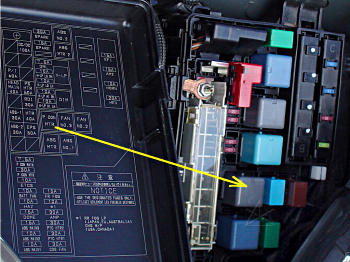

    copying from hobbits prius tech training
    Prius tech training
    2nd-gen is more difficult
    Electric pawl actuator, special 3-phase drive motor
    Shift to N, then pull the PCON MTR relay
    That disables Park, but the car gets unhappy
    Do what the screen says: set emergency brake
    ... then you can at least shut down
    Once restored, clear the error state DTCs
    Ending quote from link
    My question is, can the car be driven, indefinately, with the relay removed in the above manner?
