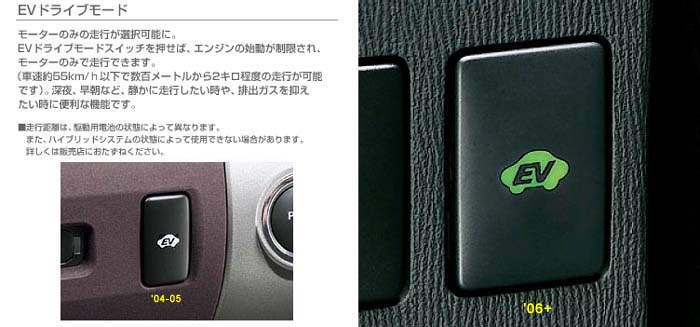

    You mean this one?
    I doubt that that's the right button, since the 06 button is reportedly smaller. That looks like the 04/05 button, doesn't it?

    Yeah the left one looks like the 04/05 one and the right looks like the new 06 version since it's shorter and fatter. I'd suggest PMing Areometer and ask if he has the 06 version in stock or whether they're on order. Also, yeah perhaps take Evan's advice and do a test first.

    Crap. You are right. I just measured them and they are not the same. I thought I would get a head start and order it before I got the car. Oh well.

    Is that for the 05 or the 06? I see both in the picture?
    If not where do I get the 06 EV button from?

    16,402
    Both. The right one is the 06 as you can see it's shorter and fatter
