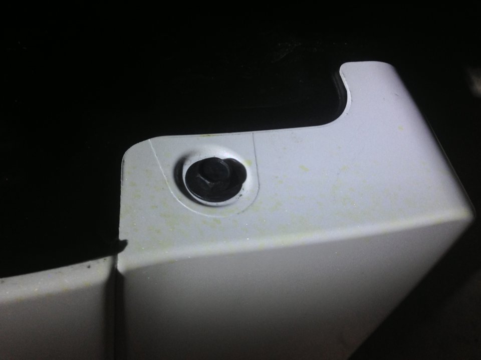

  4. Paulskim586
    Paulskim586 New Member
    Sep 11, 2013
    Sorry the photo's a bit crud since I snapped it with my iPhone. I hope you can see it, but this is the front passenger fender well directly behind the wheel.
    I have speckles like this behind each wheel on all four corners, and TINY speckles of this on both sides of the body panels.

    From your pic, it doesn't look like rail dust/iron dust. Rail dust looks like little pin size rust spots. How many miles were on the car when you picked it up? Based on the location and if it has some miles on it, another possibility is tar residue that someone drove through on a test drive. If that is what it is, you could try some Tarminator.
