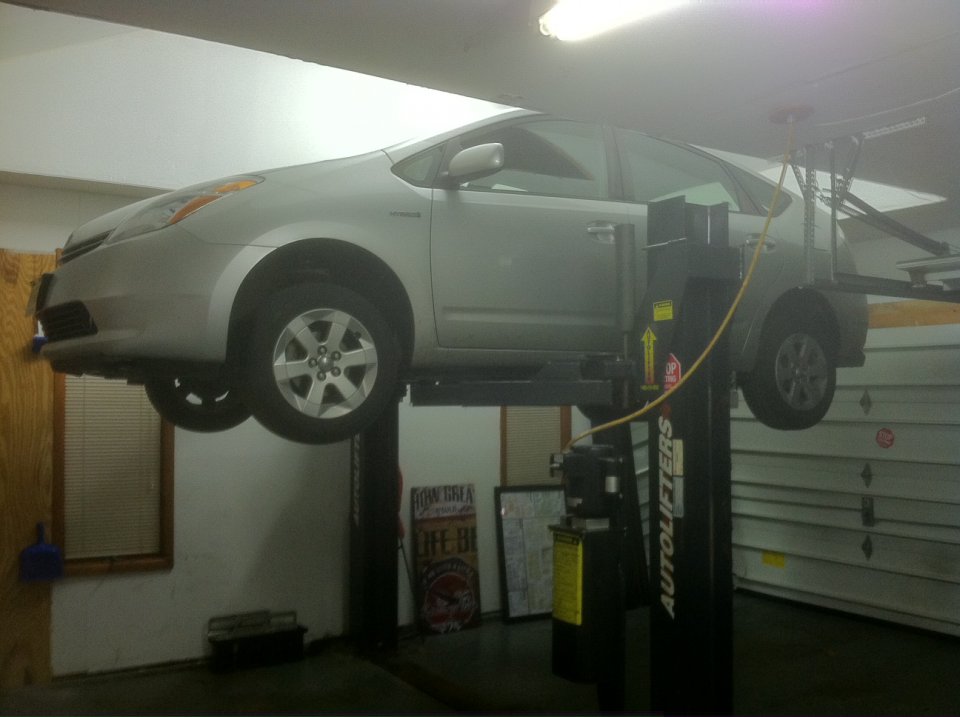

  15. ifosso
    ifosso Junior Member
    Jan 7, 2007
    21
    Forks Township, PA
    Wow there were lots of replies to this I didn't see. I've been using the lift for a few months now. There is a safety mechanism built in that prevents the car from crashing down in the case of lost hydraulics or power.
    I'd be happy to scan what I have documentation wise and send it. Where should I send it to?
  16. ifosso
    Jan 7, 2007
    21
    Forks Township, PA
    PS - Here is a shot of it in action. And anyone within distance of Forks Township, PA is welcome to use it.
