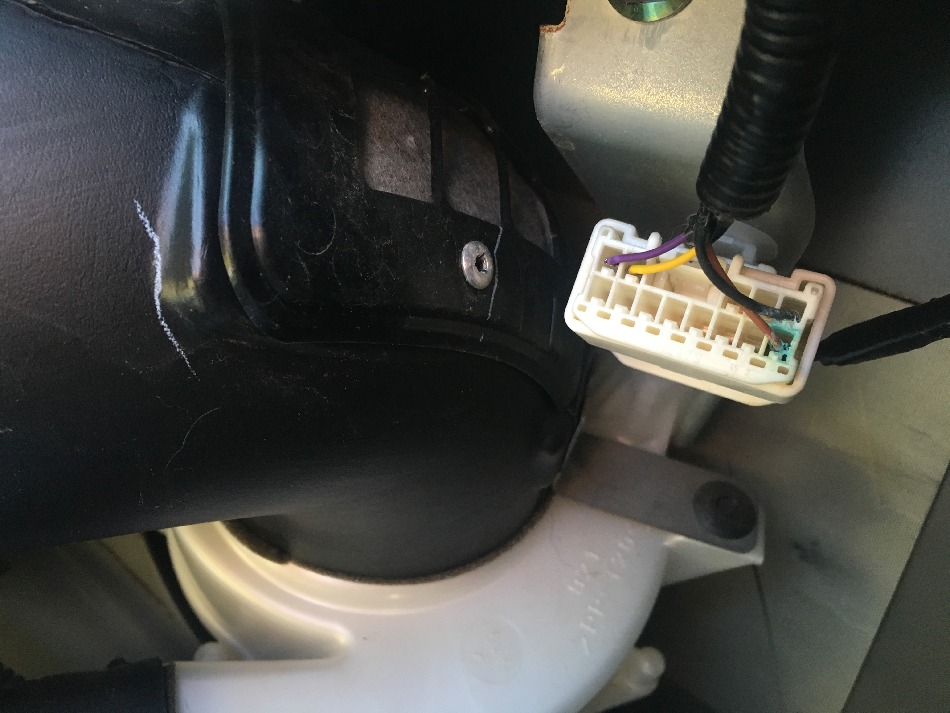

    Yes. Consider replacing a module or two, then top balance or cycle the pack.
    Have you checked or cleaned the associated HV battery fan connection already?
    Try removing the sticker and place a drop or two of machine oil on the fan spindle (with or without removing the circlip first).
    Check all of the connectors on the left end (drivers side) of the HV battery, including the the harness and HV battery ECU (below) :

    The battery fan does need to work (and you need to do something with the HV battery itself.)

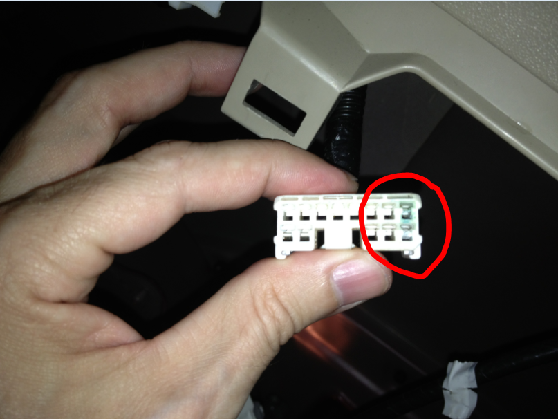

    As mentioned, the connector near the fan itself commonly gets corroded from water leaks around the tailgate body frame. Then check the connection at the fan itself. Also might want to check the small relay that supplies power to the fan- in the wire harness attached to the air duct(?).
    The battery ecu monitors the negative control side of the fan motor. With the fan off there should be near 14V at the ecu. When the ecu commands the blower "on" at lower speeds, the blower module partially grounds (pulse width duty cycle) the negative circuit. So there should be around 8-12V on the (-) monitor circuit, with voltage decreasing as fan speed increases. At 100% on, there should near 0V.
    If the ecu doesn't see the voltage it expects (when it expects), then you get the P0A84.
