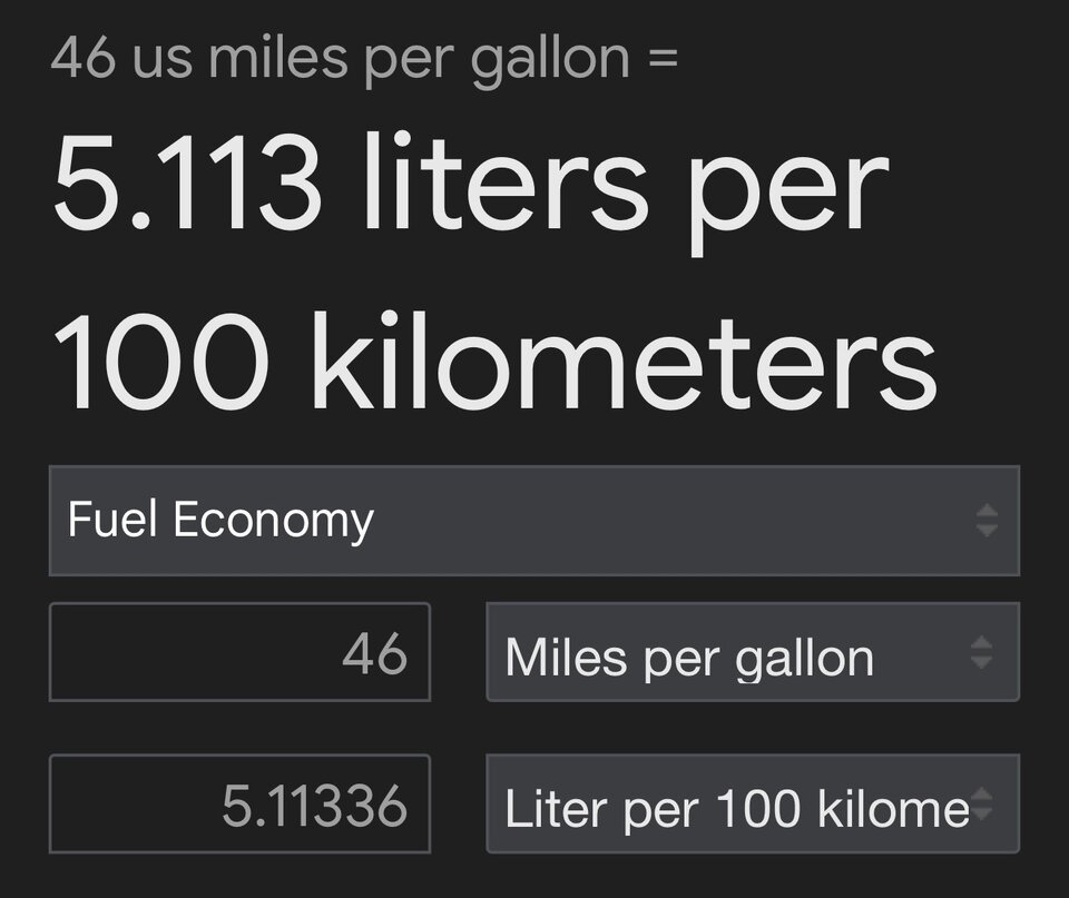

    The US government "epa standard" for testing hybrid mpg is reasonably accurate and was shown in post 2.
    There is no doubt gen4 and 5 Prius vehicles operated properly get better real mpg than a gen2.
