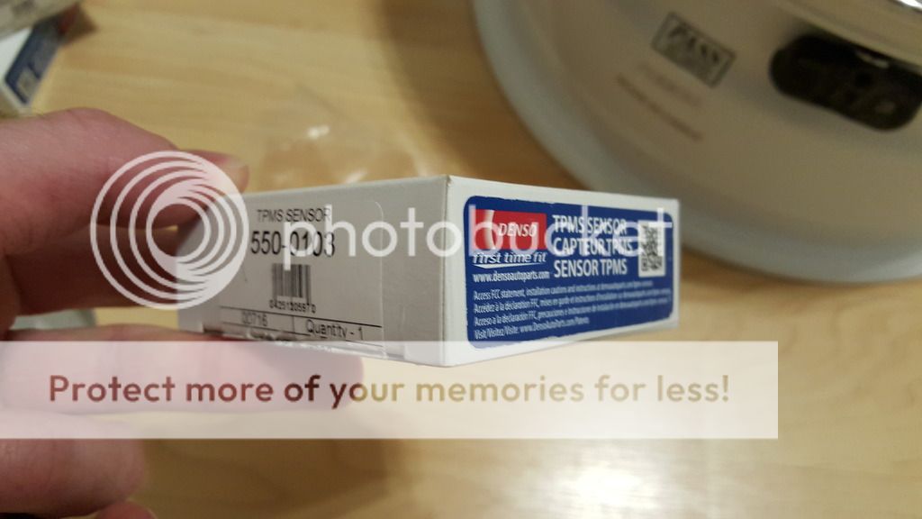

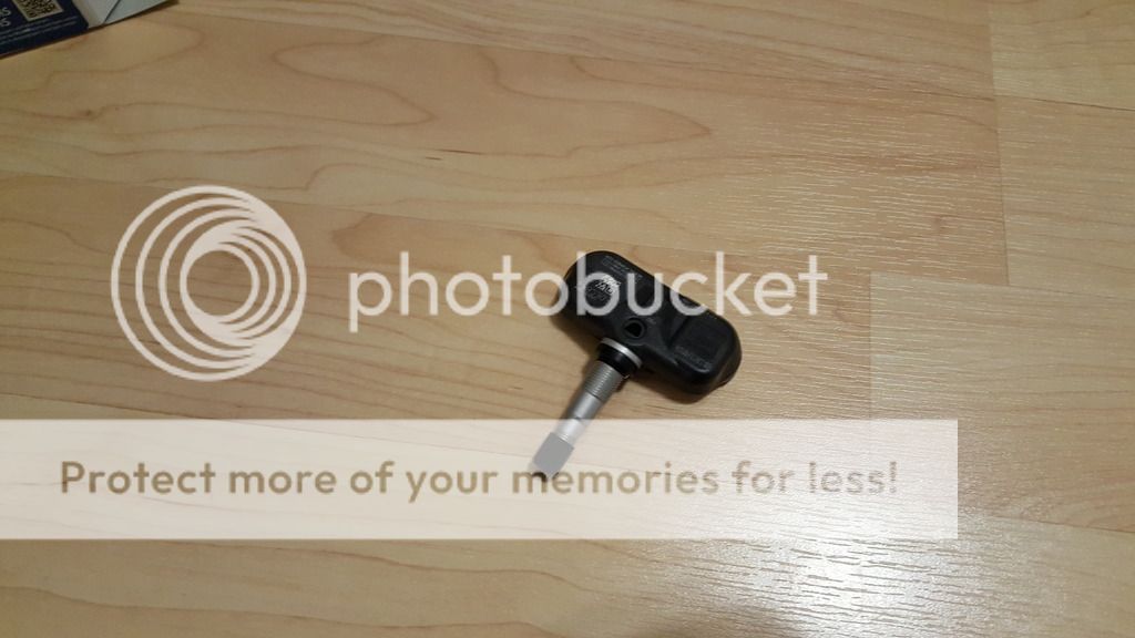

    Was also going to ask, the new tpms sensors, does anything need to be done to them before installation? They just came in a box with no instructions.. I was going to just install them, put the tires on, and then deal with programming them later, is that okay? Or do I need to do something to them before install?

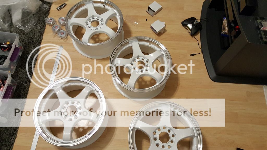

    Here are some pics of my new stuff! Going on my white 08 Prius
