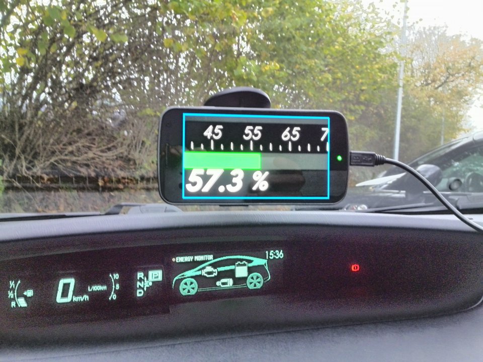

    Today i used my time to play with my new OBD modification with my Samsung Nexus Phone i dont use anymore. Instead i use it to connect with my Bluetooth OBD, and beside reading Coolant temp. and other various sensor data. I can now view the Hybrid battery status more accurate now.
    Under my readings i found interesting that the Prius does this for optimizing the battery life:
    Under driving it keeps the battery between 39 % - 62 %, so 39 % on the (cars) display is low battery. (2 bars)
    Driving on highway with constant speed the cars computer keeps the battery charge to maximum 60%-62%. (6 bars). It shows 6 bars from 56%.
    When running on Elec. (without EV) the engine first keeps in when it reach 39%.
    Ev Mode is available from at-least 50% battery power and deactivate at 45,5%.
    Hope this information is interesting :)
    and sorry my bad English

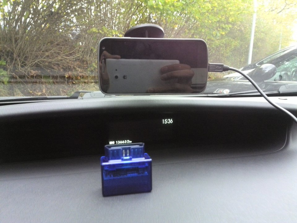

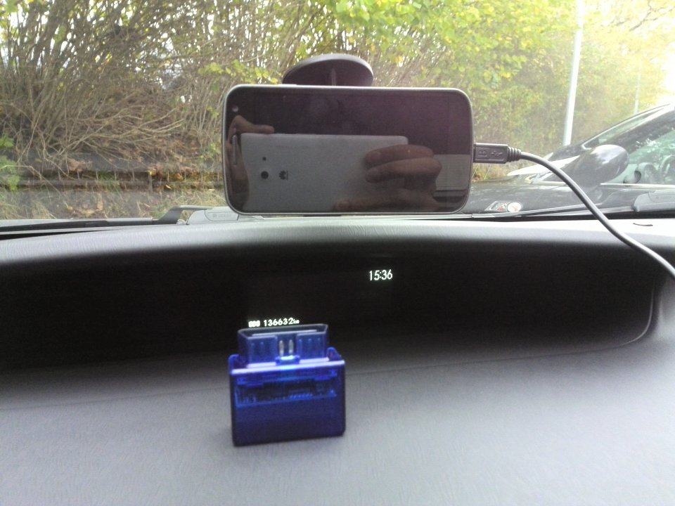

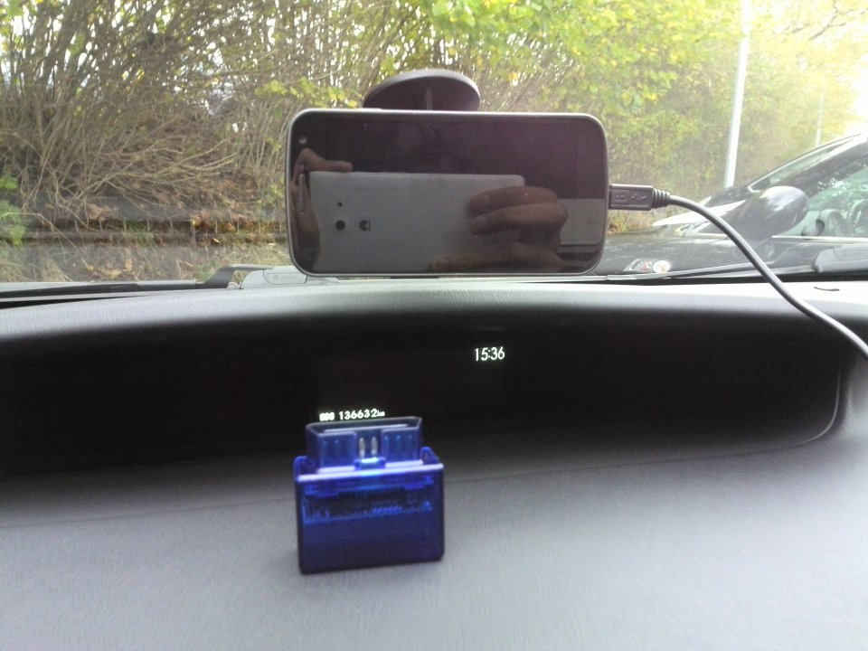

    First Picture (Battery readings)
    Second Picture (my OBD connector)

    I guess we have different driving style. My battery never goes below 55% and stays at 62%-72% and spends 80% of the at between 64%-68%. The city speed limit here is between 35 and 55mph with traffic lights between 1/4 to 1/2 miles. I'm able to speed up to the speed limit and regen brake back to stop.

    That looks like the ELM327.

    Yes the model i use is:
    "V1.5 Super Mini ELM327 Bluetooth OBD2 OBD-II CAN-BUS Diagnostic Scanner Tool"
    i Bought it from amazon :)
