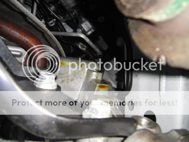

    I noticed these oil droplets hanging on the staircase like structure on the backside of the engine block:
    Are they normal? Where do they come from? I vaguely remember someone has also seen these. Thanks!
    Date was 20101030 and mileage ~ 15000

    Oddly enough I had another 09 Prius in the other day for this. Cleaned affected area, placed dye in oil, advised cust to drive a few hundred miles and return. Once cust returns, will find source of leak via UV light and repair under 5yr/60k miles warranty. Have it looked at. :)

    i found the same problem at the same spot on my 07 with around 50K miles at the time. i wipe the oil clean only to see it return after every 100 miles or so. the first dealer put a small bottle of dye in the engine oil to diagnose the location of the leak. after 700 miles the dye did not show up conclusively under UV light since only a drop or two of oil leaks out. that first dealer (Hillside Toyota in NJ) refused to fix the problem stating that it is normal based on the dye test, they would not fix it based on my suggestion that the timing chain cover gasket needs replaced, even suggesting that i spilled oil during oil changes.
    then I went to a second dealer (Caldwell Toyota in NJ), showed them pictures, and told them oil is leaking from the timing chain cover and the gasket needs to be replaced (info gotten from this forum). the Prius tech first took out one of the bolts holding the timing chain cover to the block closest to the leak and applied sealant around it, then put it back in. i drove around for 200 miles and the leak returns. the same tech then replaced the entire timing chain cover gasket (a sealant) under the 60K mile power train warranty. while the cover is off, he also noticed the water pump (for ICE) was not spinning freely, so he replaced the pump, also under the power train warranty.
    the entire repair took 5-6 hours and free for me and i got a brand new water pump. the car is at 63K right now and the leak has not returned. this repair took me 4 trips to 2 dealers.
    i would suggest you go to a dealer and not have them use the dye test, if possible, since it was a waste of time for me.

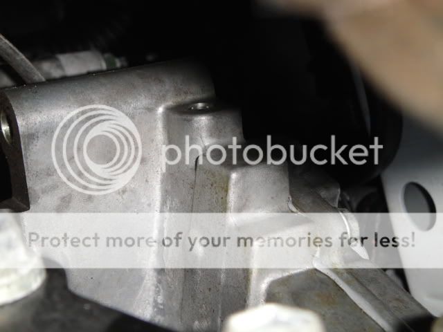

    I have been watching and hoping but the leak came back. :(
    I took the picture and wiped clean again.
    Date was 20101121 and mileage ~ 15600.

    Post #3 refers to the timing chain cover which is on the "front" of the engine (i.e., the side facing the passenger-side fender.) Your title refers to the "backside" of the engine which implies this is the side facing the transaxle (or perhaps you meant the side of the engine facing the firewall?)
    Please clarify the location of the leak (or else pls provide a photo zoomed out so that we can orient ourselves...) I am also wondering whether a small mirror might help you to inspect further, to see from where the leak has originated.

    Thanks! I meant the side facing the firewall - didn't know the engine orientation is perpendicular to the car orientation so I was going by the car orientation. In the very first photo posted you can see part of the rusty drive shaft at the top of the photo. And yes the area is indeed near the passenger side fender. When I have some time I will inspect and report back. Would the timing chain cover more easily seen from above or from below?

    Well, it probably isn't that easy to see either from the top or the bottom. You might have to remove the RF tire and fender liner in order to get a good view of the "front" of the engine where the timing chain cover is located.

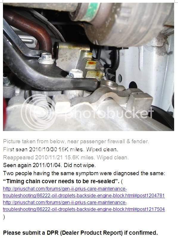

    Timing chain cover needs to be resealed, will be covered under 5yr/60k mile warranty.

    Was this the diagnosis of your customer's 09 Prius quoted above? Is there something I could refer to when I talk to my dealer? TSB? Repair paperwork with private info blanked out? Thanks!

    Yes. No TSB's (not for Prius anyway, there is one for the 1GR-FE 4.0L V6). Timing covers reseals on Toyota's are not all that uncommon. Your Prius won't likely be there first Toyota that needs a reseal that they have seen. When you take it in and they complete repair, please, please, please ask them to submit a DPR (Dealer Product Report), this is how we get TSB's and improvements in part/manufacturing quality.

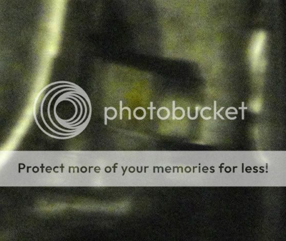

    Quick update: A new photo taken through two mirrors - too lazy to set up the ramps and crawl under the car - the droplet is back again:

    Are you sure that isn't a photo of an extraterrestrial being? :madgrin:

    Just wrote up something to print out for the dealer before going in. Did I miss anything?
    (To see full size image: click on the image, then click on the "+" sign with a circle around it at the upper left hand corner of the pop-up image.)
