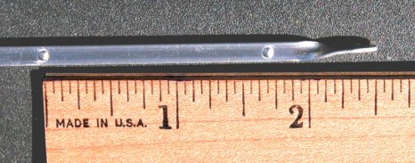

    1/2 inch beyond the full mark is overfill, which bad for the engine.
    There's simply no excuse for missing the middle, between "add" and "overfill", so greatly. That's whole quart more than they needed to add. Remember, 3.9 quarts is the maximum. More than that is beyond the full mark. In other words, too much.

    <div class='quotetop'>QUOTE(Gurmail\";p=\"51019)</div>
    Half an inch?!?!? I'd worry about that, it is WAY more than just a little over. You'll note from John's picture that the entire 1 quart range is 1 5/8". Use Dave's turkey baster or even Tony's dip-wipe-dip method if necessary, but do something.
