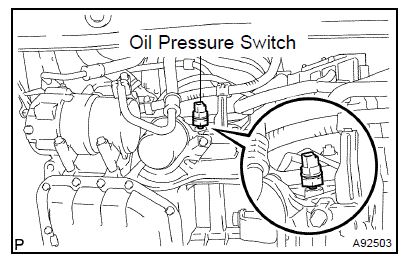

    Does anyone know where the oil pressure sending unit is located? And could that be the cause of your low oil pressure when you still have almost full oil on dip stick?

    I have not driven it ever since. but I would like to change out the oil sender first to see if that works before I bring it in. problem is im not sure where its located.

    thank you bedrock8x. I will change it later today and see what the outcome is and keep you guys updated.

    That looks to be in a reasonably "easy" (If there is such a thing when working in a compact area such as the Prius engine bay) area to access. I cant see running into any problems.
