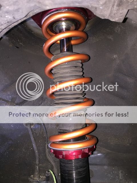

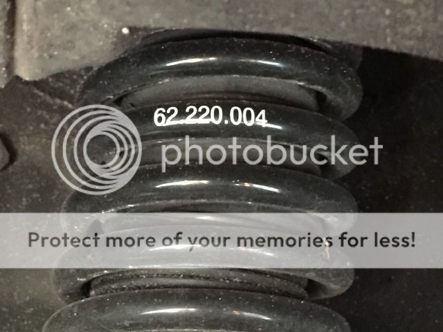

    The reason was find out that the front springs are junk!
    Sr for the pic. This one was taken long time ago. I forgot to take pic before the fixing. Basically, the coils springs dont' have much stroke when the car sitting on the ground. That explained for why the car keep bottom out even on small bumps.

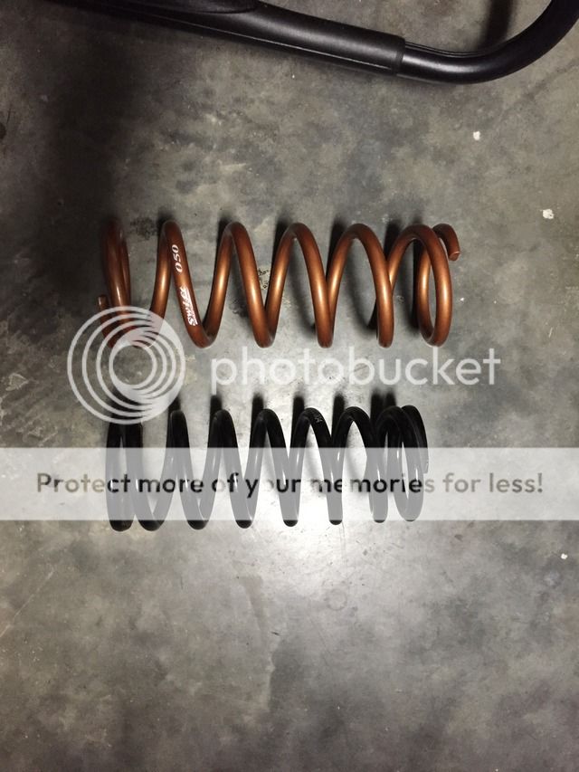

    So, here is the solution:
    The orange is Swift spring, spec: 65 Inner diameter, 9 inch long (bad choice), 5kg
    Compare to stock Mega: 62 ID 8.66 inch 4 kg
    Why Swift spring:
    *Best coil spring you can find.
    *It's expensive? Yes, ~175$ for a pair. Swapping spring is not 10 min work so I don't want to do it twice
    *why 9 inch long is a bad choice. You cann't go too low. You just can go littlbe bit smaller 2 fingers gap between the fender and tire. I should buy 8" :(
    when the car is in air. I will upload the pic when the car is on ground later.
    The Swift springs have much stroke compare to the stock Megan. 9" more stroke thang 8", that is the reason I went with 9", but I didn't know it would make the suspension cann't go lower. But that ok since I don't like slammed look ( function vs looking)
    The Result
    The car much much muchhhhhhh feels better, not more bottom out even I drove faster (55mp) on the roads with same pot holes, bumps, DIP as I drove 45mph before. Handling much better, very very predictable. I can say where is the limit of the car when it is in the hard corner, much less understeer. The rear spring is just OK, I just dont want spend more money on this car since I suppose saving money not spend more. I recommend swap rear spring if your budget is allowed.

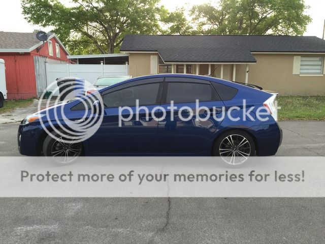

    This is my car right now
    feel free to ask!
    When car on ground

    Glad you found a solution to your bottoming out issue. Can you take a pic with the front wheel straight so I can see the front gap better. Any reason why you went with the 5Kg springs instead of the 4Kg? Also, what was preventing you from going lower?
  3. BigBear2010
    BigBear2010 Member
    Feb 7, 2014
    156
    65
    I went with 5kg on front to make the car less understeer
    I just dont like go low bc i hit bumps in my uni campus.

    2) The pics with your drop, is that all the way down in front? Did the extra .34 inches in spring length really reduced your drop that much?

    2. It it not all the way down, I can still go down more but since my tires 215/50/17 so they will rub the front fender. I recommend get the shorter length than my spring if you want to go low. My springs length reduce lot of drop
