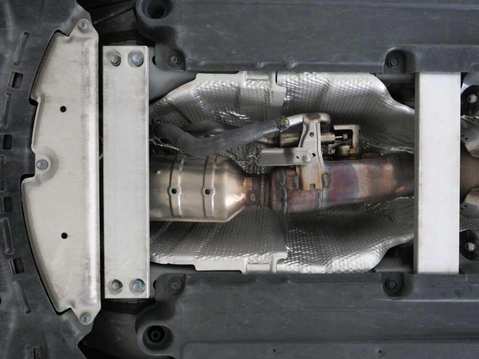

    Hi All , I live in non carb state with no smog checks locally where I live. I have a gen 2 and don’t know a lot about gen 3. Details are 2011 with 250k miles, cat just stolen. Car is in Cali a couple hours away. Plan is to go check it out next weekend and install an after market one to get it home, then do a bunch of updates and pass on to a family member (and install a better cat once proven reliable).
    Owner says no evidence of coolant drain on ground after cat was stolen and coolant reservoir still full. Also says he doesn’t believe there is oil consumption, Here is a pic of what he sent. Did the thief just steal the first part of the cat ?
    Anything else I should plan to look at and check out before I purchase it ? 420DC6DC-551E-4B3C-972F-AA4B9E0710F0.jpeg

    Main outstanding question for me is did the thief only take half of the cat ? It looks like the coolant lines are still intact and the owner said no coolant puddle in his driveway and it’s still full in the reservoir.
    or is it possible to steal the full cat without having a coolant spill ?

    It would appear that the heat exchanger is fully intact.
    Here are a couple of images that some show a complete assembly.
    The images below of a failed first attempt show how some are removed by cutting the metal tubes or rubber hoses.
    Stolen catalytic converter in london uk | Page 33 | PriusChat
