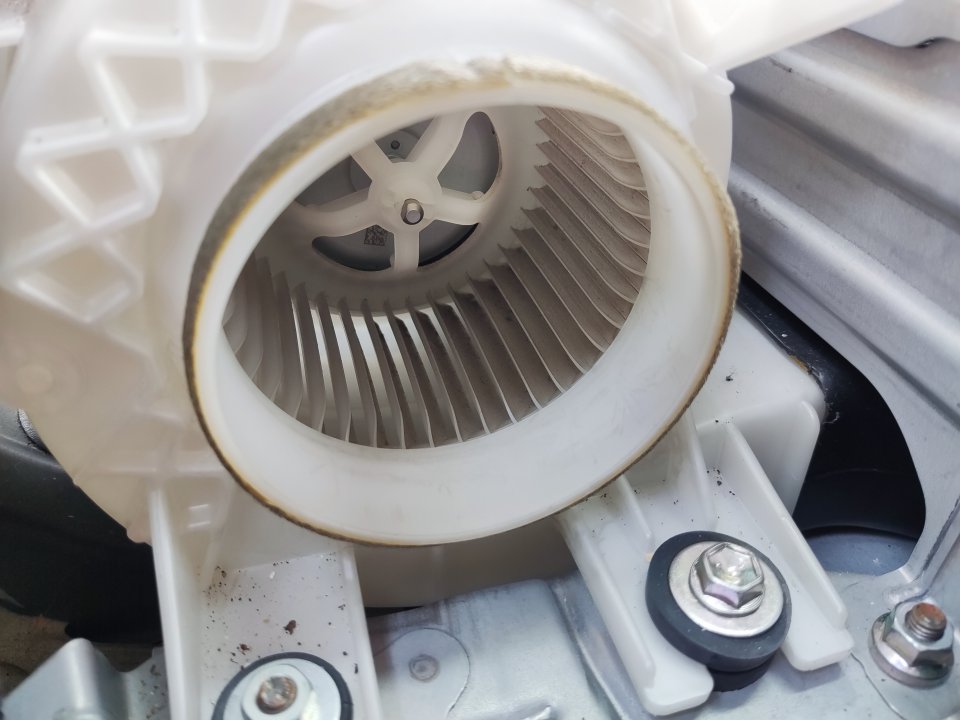

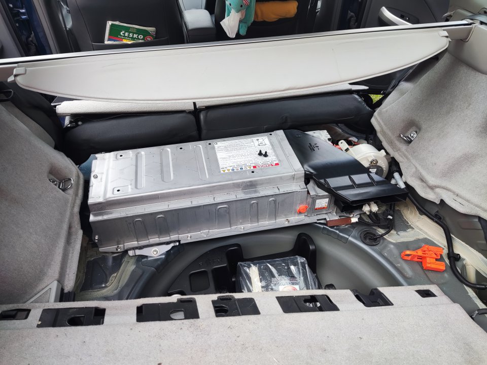

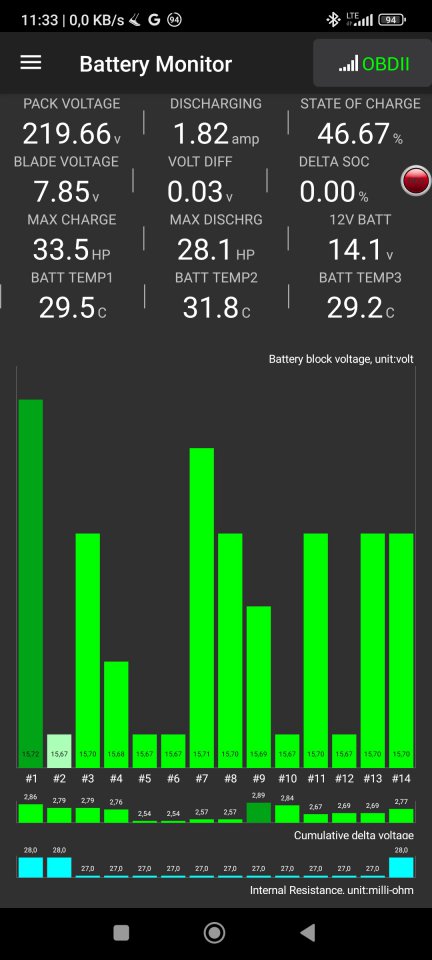

    Summer has started for us and temperatures are rising to 30°C here. I always drive with the Hybrid Assistant app turned on. However, the temperature of the traction battery always rises to 48°C, when the recuperation is switched off during braking.

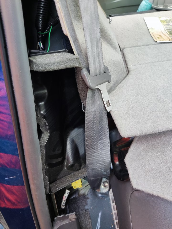

    Because I thought the battery was poorly cooled, I disassembled the cooling from the seat to the fan. All ok, fan clean, tunnel clean. I didn't look under the battery cover. I always run the fan on level 6. The air conditioning in the car always goes to 22 degrees. Air at a temperature of about 33 °C is drawn into the battery fan.
    According to Dr.Prius, my battery is at 60% capacity.
    My question is: Can the battery overheat because it is already old? No error message pops up, no exclamation point. Yet.
    I'll try to attach some photos.

    yes, old cells will run hotter, or corrosion inside the battery case will also do it

    All new cells will always be better.
    Just make SURE all the cell are NEW, and not just refurbished, which are used cells
    supossivly "balanced".

    always the new battery is better, and that is a very good price. replacing bad cells is still leaving all the other old cells which will also go bad eventually.
