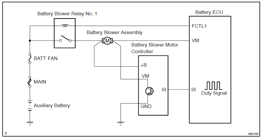

    If this is a 2007 we're talking about, the battery blower isn't controlled from the HV control ECU in the dash; it's controlled by the Battery ECU inside the battery.
    To make the blower run, the battery ECU has to do two things: (1) it pulls FCTL1 down, so the battery blower relay will close and supply power, and (2) it outputs a pulse train on SI to the battery blower motor controller, which pulse-switches the low side of the blower so the widths of the pulses control how fast the fan runs.
    The voltage on the low side of the blower is monitored by the battery ECU on its VM input to make sure things are going as planned. The higher the wanted blower speed, the lower VM should go. (For lower blower speeds, VM rises up closer to 12 volts, so there is a smaller voltage drop across the blower.)

    At this point I would suggest using a (capable) scantool to command the fan ON then measure voltages at each of the 4 wires of the fan speed controller (while everything's plugged in and the car is ready).
    If there was a problem with a temperature sensor, then it wouldn't set the codes you have. That said I would use a scantool to view temperature data in the HV battery ecu.

    Well you are in Pennsylvania so no telling what's really going on like others have said command the fan with whatever programming tool you're using if it's capable If not get somebody with TIS2 to command the fan to run see if the fan runs and all the speeds and work backwards from there like has been mentioned. Jumping out the white connector in the back is a pretty standard operation so that's been handled I think I remember you talking about this before. So that's out of the loop. So other than the fan speed controller and what have you that's pretty much it and yes I would think it would be the ECU back in the battery not up in the front of the car as the fan temp sensors plugs and all that are back there near the battery hello how one would think a computer way up in the front of the car would be handling this just by sure thinking about it seems kind of silly when there's a battery ECU right in the battery case in the back of the car with the battery the fan and all the rest of it. Just seemingly how I would think about it anyway why would you run a harness 15 ft up to the front of the car to handle that when the battery ECU is already back there with the battery but anyway.

    P3000 is a generic code that the HV control ECU reports. (It can mean "hey, a little bird told me about something going on back at the battery ECU, you might check that out." But because the code itself is reported by the HV control ECU, they can't leave that ECU completely off the suspects list.
