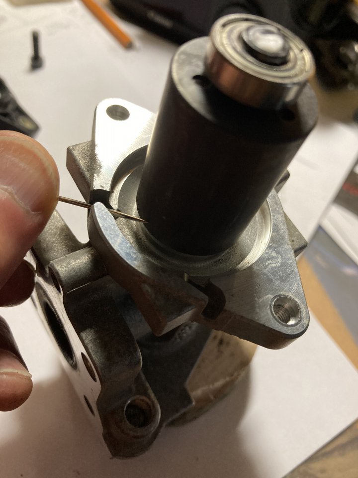

    Another thing, I did pull off the top of the EGR valve to inspect the magnet, and didn’t realize it “spins” so not sure if there is the certain way to clock the valve and if that would cause any issues.

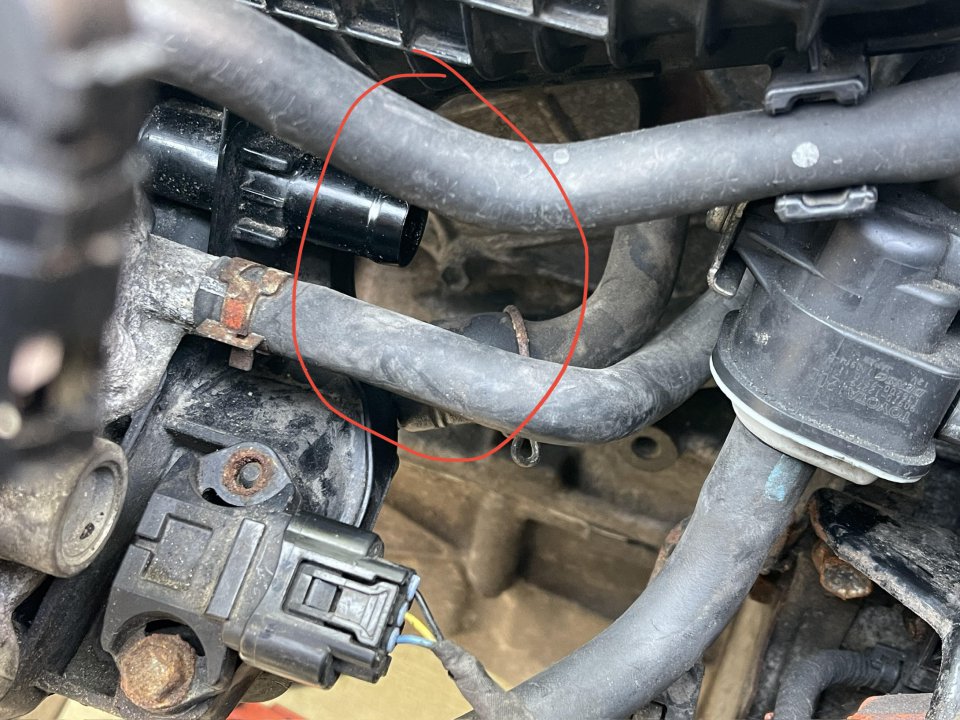

    Well it's running, and a quick test drive seemed normal. It seems I left off PCV vent hose. Still need to clear codes and such to see if my EGR cleaning has solved my P0401 and P0420 code, but I was able to drive around the block, drprius app stating 60% SOC on the hybrid pack so feeling better about that as well.

    As long as you don't get it wedged up somehow when reassembling, it 'clocks' itself the first time the ECM wants to close it, down to where its little ski jump hits a metal stop.
    While you had it off, I hope you checked for any sign of the ski jump having a rut through it.

    Here’s a trick I used to keep the internals of the EGR valve from unwinding when putting the cap back on.
