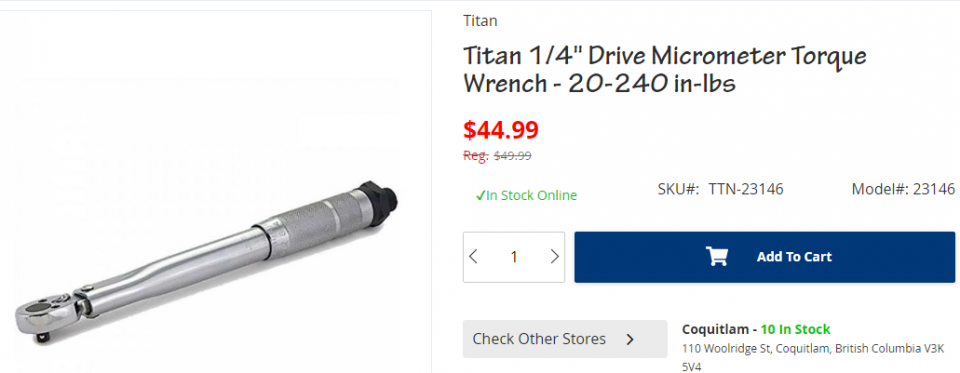

    Get a 1/4” drive torque wrench, decent quality Chinese? They’re not bad quality.
    You can crude test them: clamp horizontally in a vice, dangle a dumbbell or what have you at a measured distance from fulcrum with it set accordingly; it should just click.
    Verify the weight with a digital scale too; cheap dumbbell weight may not be that accurate.

  10. Mendel Leisk
    Mendel Leisk Senior Member
    58,766
    40,467
    I got one of these (attached) a few years back; did a rough test (per post #6) and it seems accurate, working well. $44 CDN currently, think I got it on sale for around $39.
