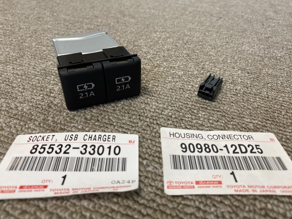

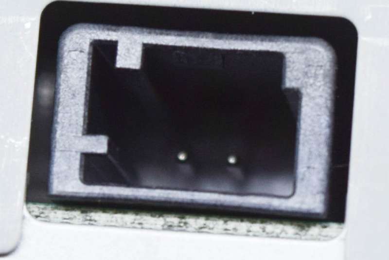

    Toyota wants 200 for a cable adapter for this usb charger I just got used for my center panel.
    The wiring is there now, but I do not have the little plug in plastic adapter.
    here is the unit.
    I would consider just replacing the whole charger if I could find one that fits the hold perfectly.... or re-use my original part.
    Really sucks because I called two toyotas... both said I could not get the part over the counter. My local does not really want to help and said $200... and it is nearly impossible to find a prius in a junk yard here.

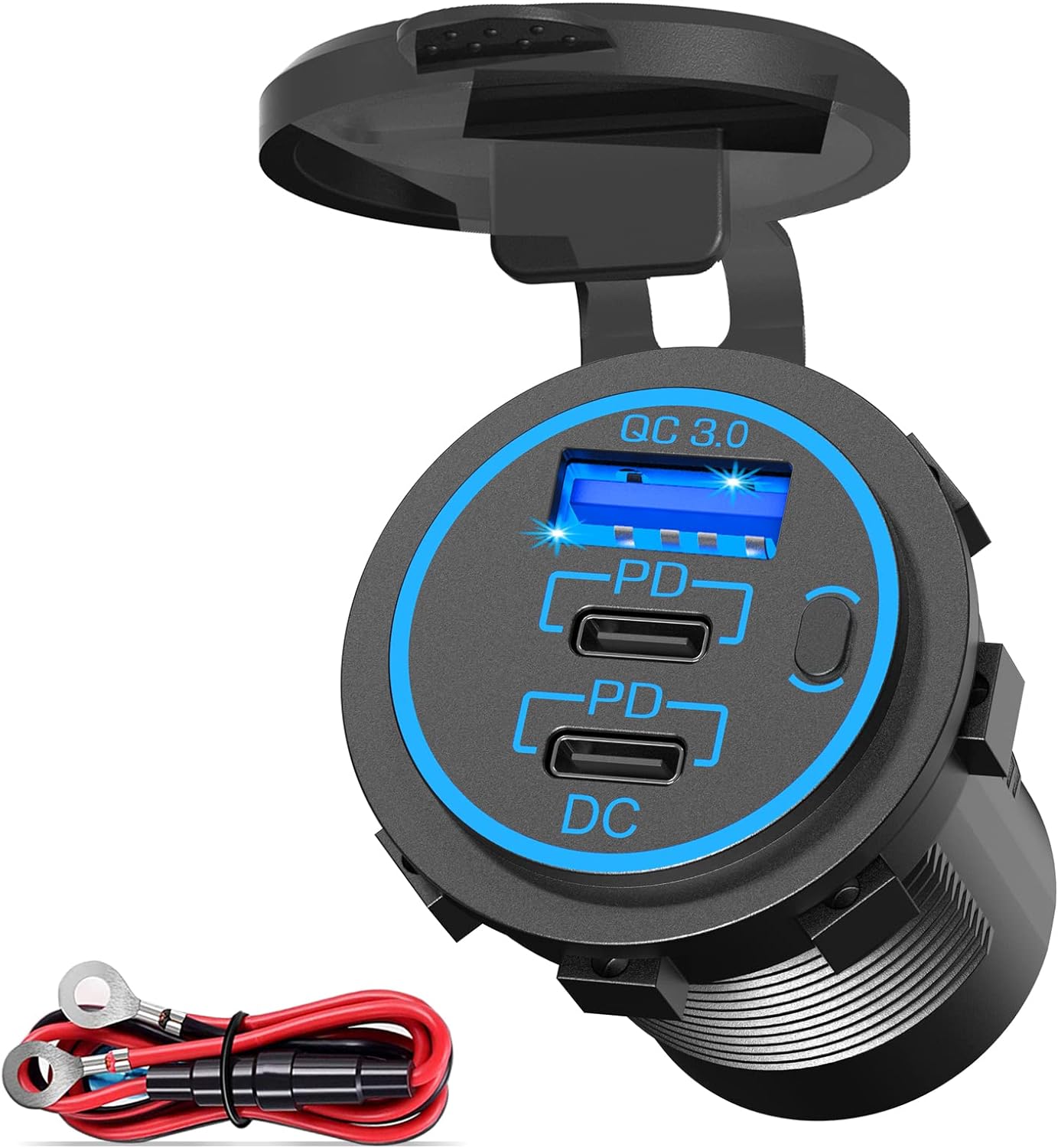

    If you look at the last picture, I replaced the original Cig lighter port with this one upload_2023-5-3_17-45-25.png
    Which, is excellent and has a shut off button.
    The problem with this one is people keep kicking it and either loosening the adapters or breaking them. The last pic shows this adapter in the middle. There must have been a connector... to the original adapter and if there was, I am pretty sure I tossed it as I have recently with all the misc parts I have been holding on to for all cars since my 86 Z28 and personal watercraft mods. Unfortunately I now need this frigging part.

    There is no connector. I have now wasted the better part of a day looking for this. I even checked the service manual and there is nothing.
    I have looked for a wiring harness diagram... NOthing, not even in the service manual.
    I have searched the internet to no end, called two different toyotas checked two Prius forums... and followed a few things you recommended which turned up NOTHING.
    While I appreciate your information, I was hoping to just get an answer or a DIRECT LEAD to the specific answer. Not search for a few more hours or days, for which I am not getting paid for. Would be cheaper to just buy the 200 dollar part. But thanks, maybe that information will come in handy some other time... And probably the most helpful links you showed required a considerable amount of money to pay.

    I am willing to bet that is the part, although I am not sure because I cannot see the other end. It would have been on the original cigarette lighter port, and I cut it off to install the aftermarket charger.

    Fraking finally:
    90980-12d25
    Course that doesn't include the type of female terminal or locking mechanism that is compatible.

    Then there is this, If I wanted to wait until june:
    https://www.aliexpress.us/item/3256803383138667.html?
    Heheh.
    I will try Toyota tomorrow and also purchased this, and may try it first.
    Should have it tomorrow. The dimensions are off by a few hundredths of an inch. If I still remember how to use a caliper correctly. Kind of tricky due to the hole dimensions and then the limited area within the panel. 44.jpg
